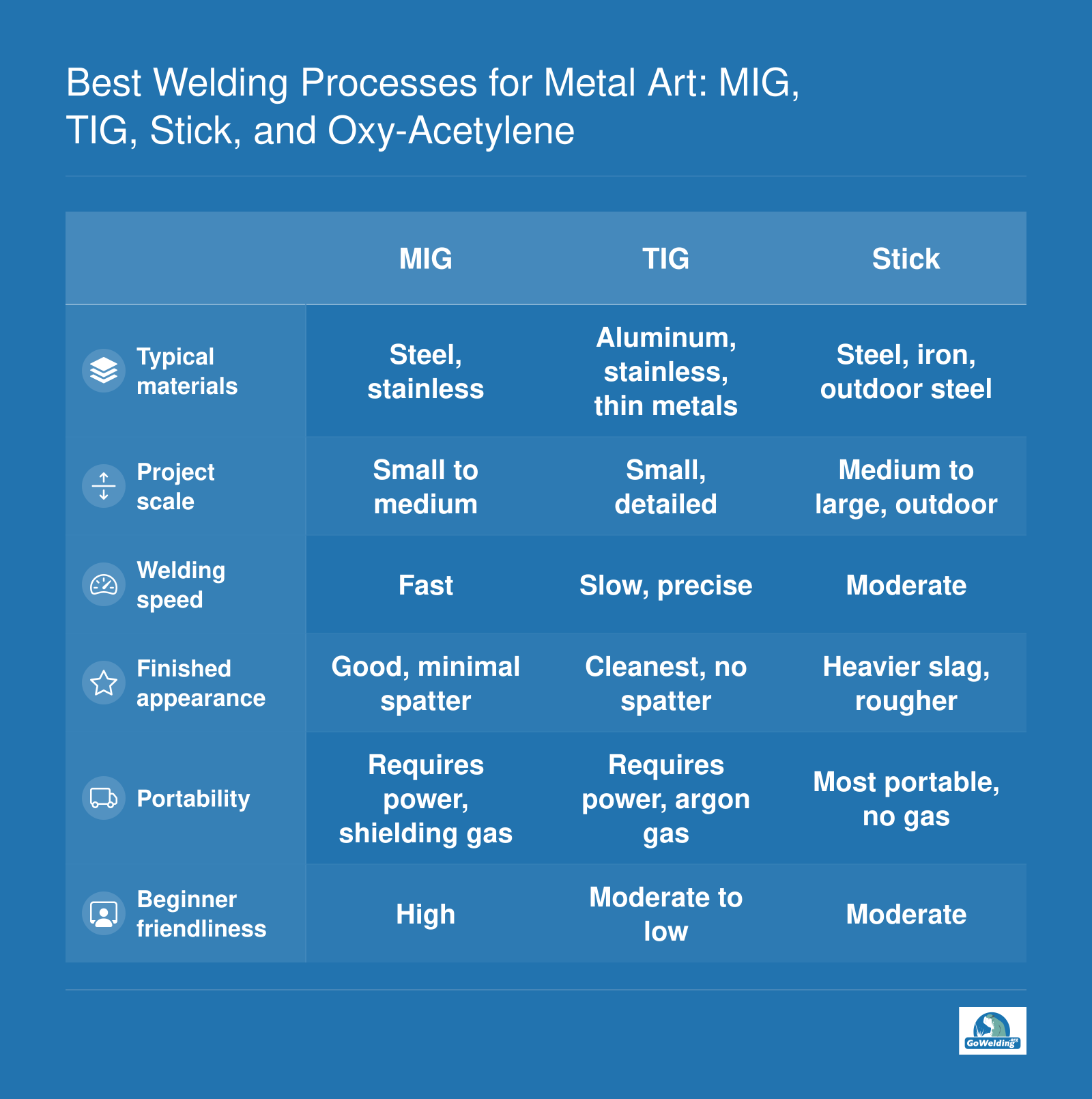

Best Welding Processes for Metal Art: MIG, TIG, Stick, and Oxy-Acetylene
For metal art, the process you choose shapes both how you work and the final surface. MIG, TIG, and stick each have distinct strengths, while oxy-acetylene is unmatched for heating and bending sculpture. Use this side-by-side to match the process to your project.
Comparison of MIG, TIG, and stick welding across materials, speed, finish, portability, and beginner friendliness for metal art.
