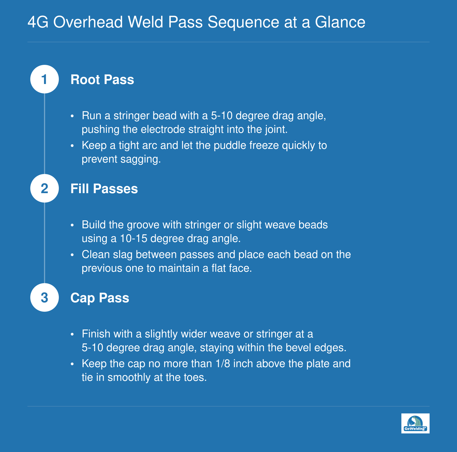

4G Overhead Weld Pass Sequence at a Glance
In 4G overhead SMAW, the weld is built from the bottom up in a controlled sequence. Each pass has a distinct electrode angle and bead placement that keeps the molten pool from sagging.
Sequence of root, fill, and cap passes for 4G overhead SMAW with electrode drag angles and bead placement.
Pass-by-Pass Technique: Root, Fill, and Cap
In 4G SMAW, the difference between a fused root and a sagging repair is usually puddle control, not strength. Overhead welding rewards a short arc, steady travel, and a cap that stops at the toes instead of piling up in the center.
Root pass: short, fast, and fused
Start with a tight root. Some 4G procedure guidance lists a 70-degree travel angle with a 90-degree work angle, while other overhead instruction uses a nearly perpendicular push angle of 0 to 15 degrees. Both setups aim for the same outcome: a short arc, a quick steady forward motion, and no lingering in the puddle. Lower the heat slightly from flat or horizontal settings, keep the electrode close, and move fast enough to prevent sag while still tying into both sidewalls. Constant speed matters more than the exact electrode angle. Watch the puddle rather than the arc. If it begins to droop, speed up or shorten the arc before it falls out of the joint.
Fill passes: clean layering beats wide weaving
A wide weave is tempting for speed, but overhead it often opens the door to slag inclusions and drips. A more controllable 4G approach is to run stringer beads, each covering about one-third to one-half of the previous bead and no wider than two to three electrode diameters. Between every pass, remove all slag and spatter with a wire wheel, chipping hammer, or grinder. Trapped slag in a fill pass will fail a bend test in destructive weld testing as surely as a lack of fusion. If the plate becomes too hot to touch comfortably, let it cool before continuing.
Cap pass: tie in the toes without overbuilding
The cap should be flush to slightly convex, with reinforcement in the 1/16 to 1/8 inch range and no more than 1/8 inch overall. Use controlled cap welding techniques such as a weave or stringer sequence, pause briefly at each toe to wet the edge, then move across the center without dwelling. Run the cap slightly cooler to keep the puddle controllable. The goal is a smooth tie-in on both edges with no undercut. A long arc, excessive weave, or hesitation in the middle will create excess buildup or a drip, especially near the cap edges.
Overhead puddle control: one rhythm across all passes
Across all three passes, the same overhead rules apply. Keep the arc short, avoid dwelling in the center, and push the puddle toward the upper side of the joint so gravity has less time to act. If the weld starts to look heavy, increase travel speed slightly rather than lengthening the arc. A short, controlled movement beats a long sweep every time in the overhead position.
