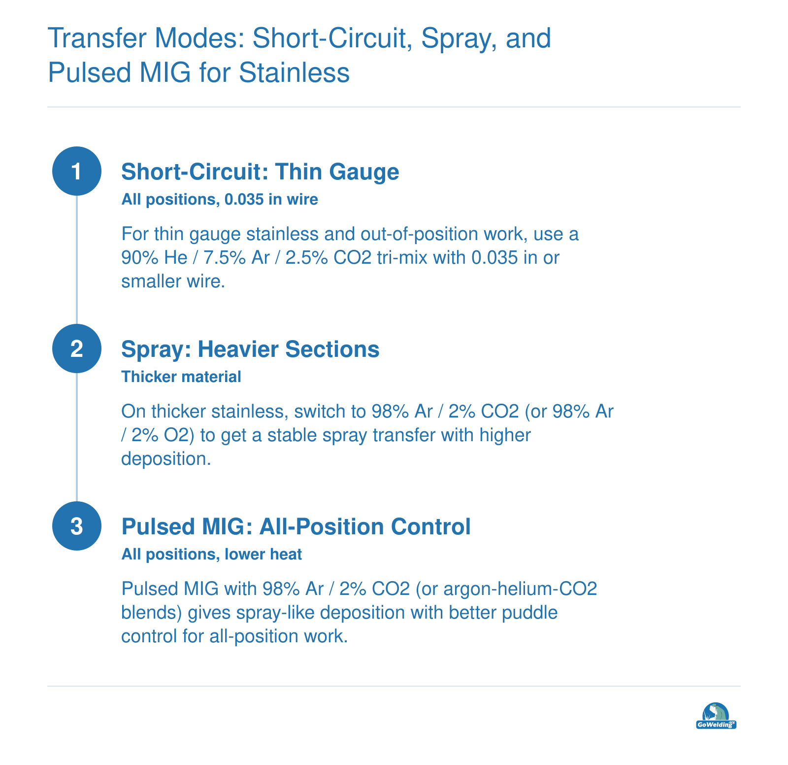

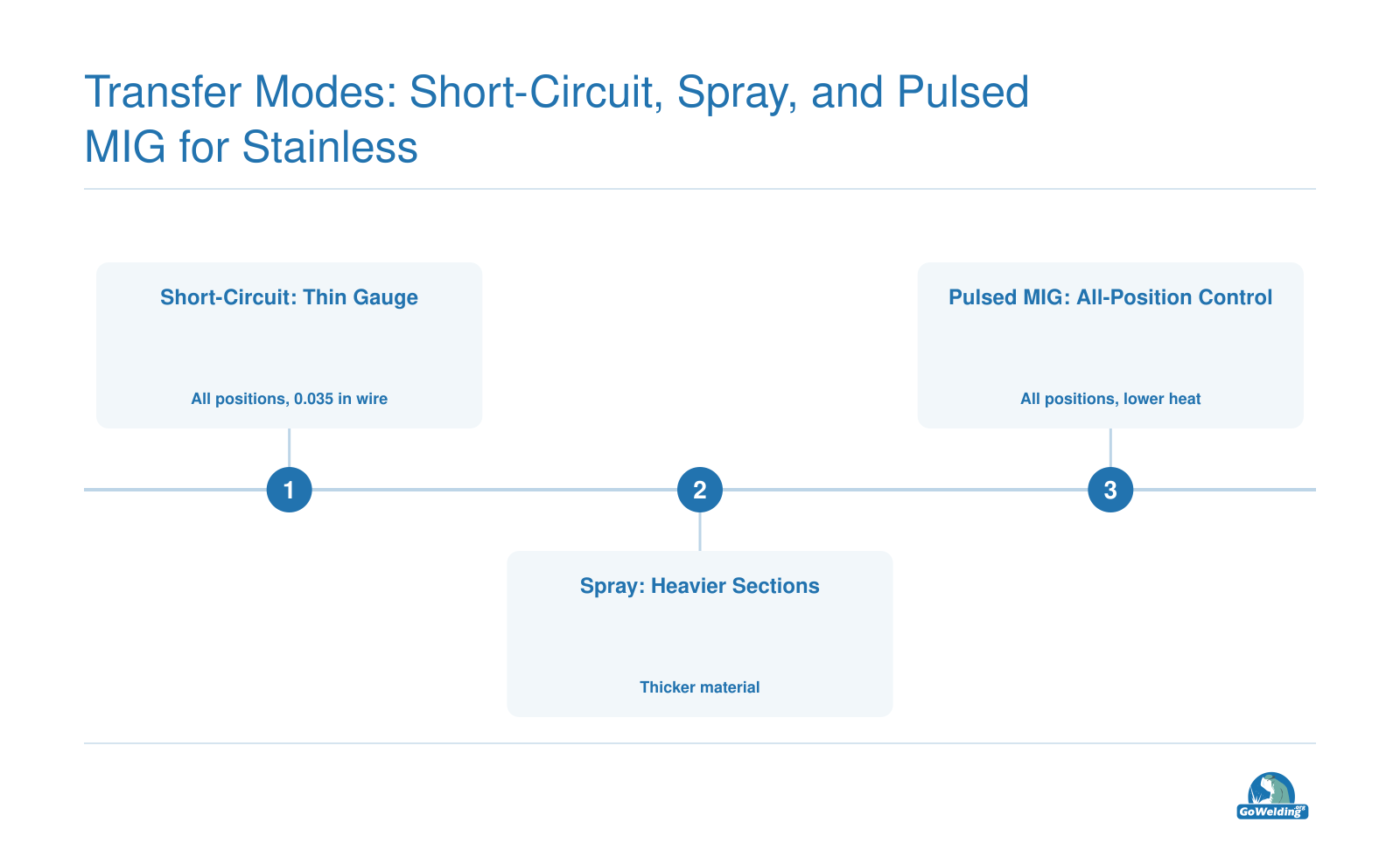

Transfer Modes: Short-Circuit, Spray, and Pulsed MIG for Stainless
Start with base metal thickness, then match the transfer mode and shielding gas to the job. The same stainless wire can behave differently across modes, so the gas blend must fit the transfer type.
Stainless MIG mode selection: short-circuit for thin gauge, spray for thick, pulsed for all-position welding.
