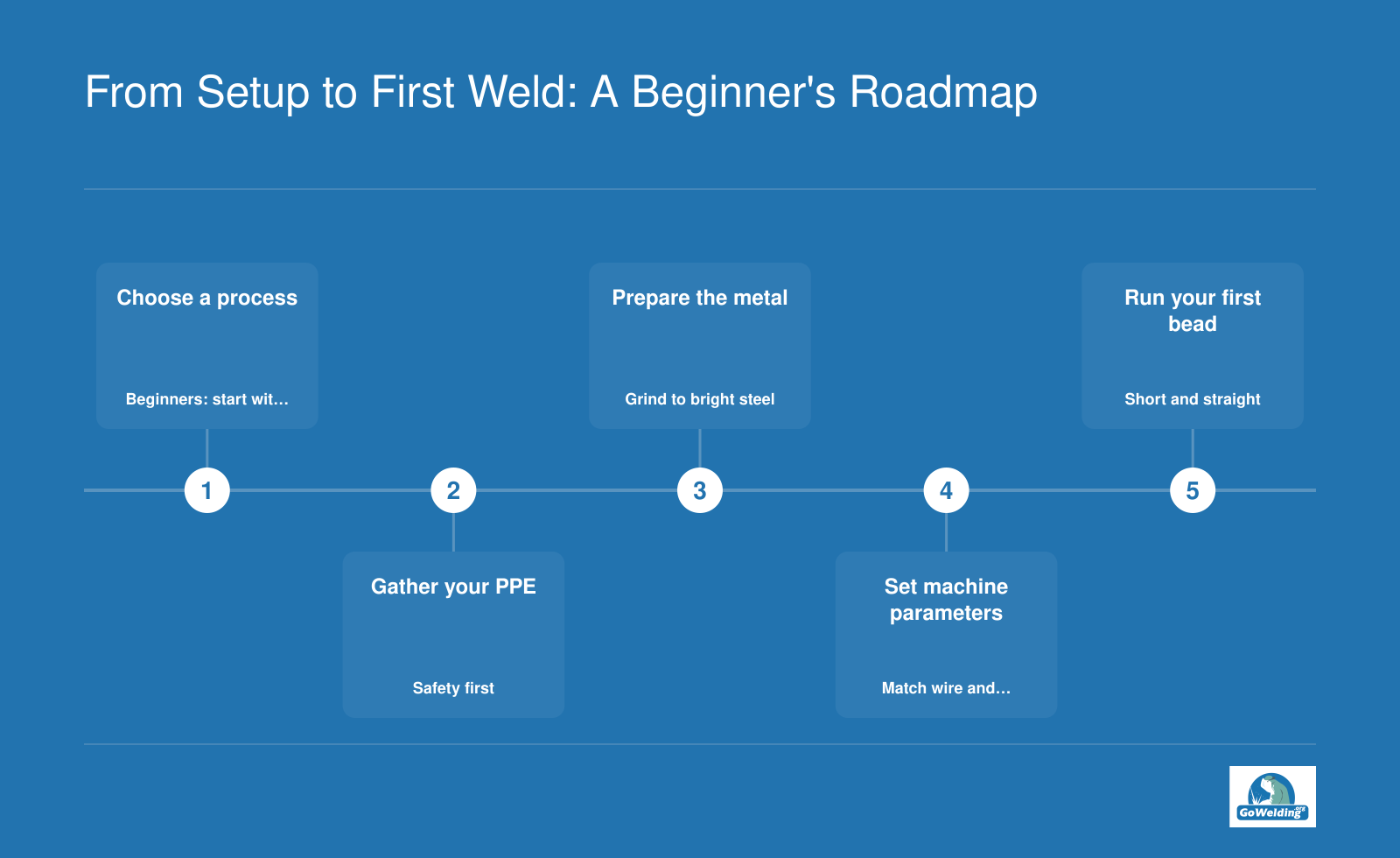

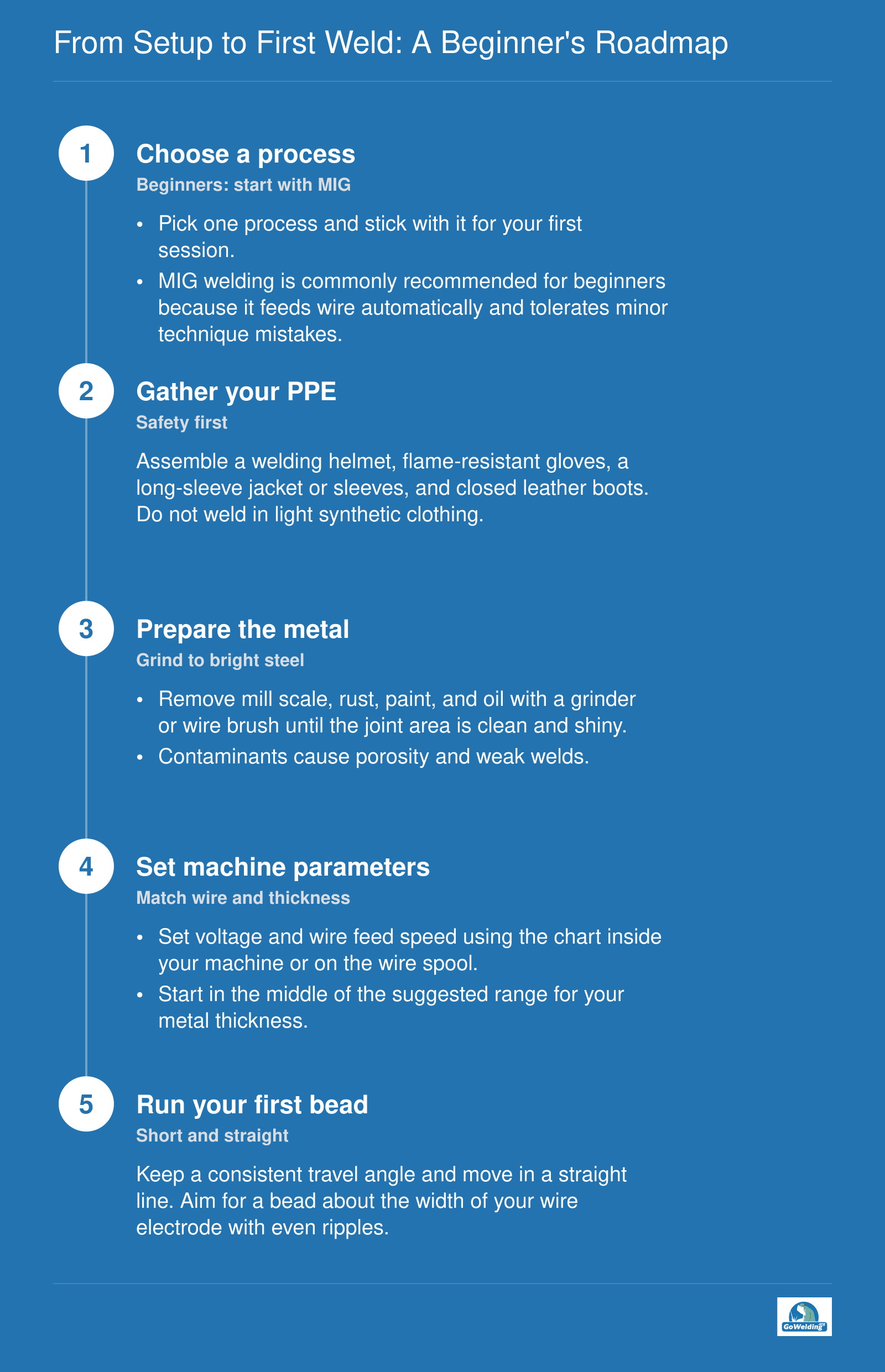

From Setup to First Weld: A Beginner's Roadmap
The path from first interest to first weld is simpler when you follow a set order. Use this beginner roadmap to build good habits before you strike an arc.
Five-step beginner welding roadmap covering process selection, PPE, metal preparation, machine settings, and first bead.
