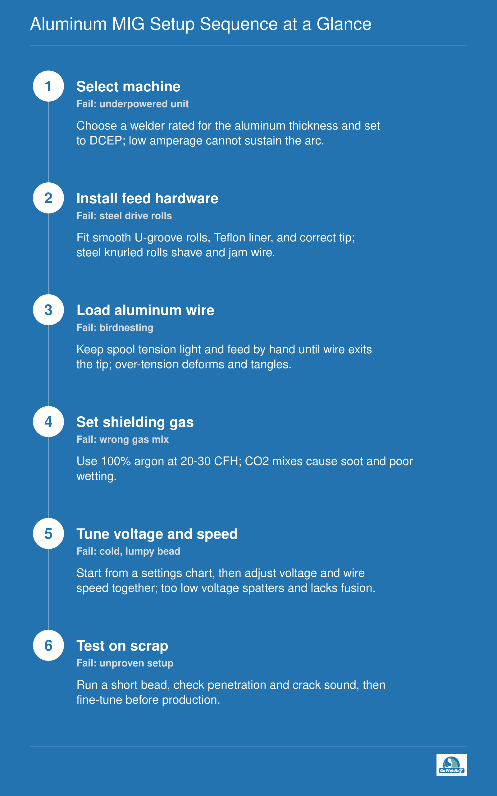

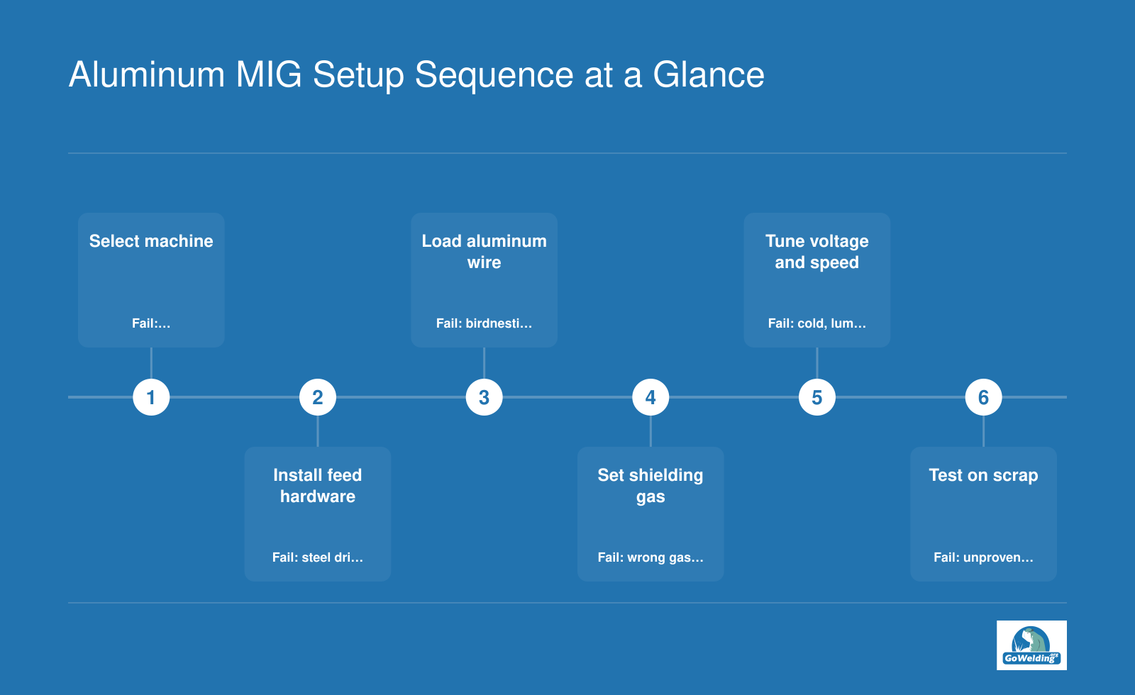

How to MIG Weld Aluminum: Step-By-Step Setup
A 120V machine or a 230V machine changes what's realistically on the table before you ever load wire. A 120V unit can manage thin sheet, maybe up to 3/16 inch under good conditions, but it struggles to keep heat in the puddle long enough for a clean tie-in on anything thicker. If you're buying new MIG Welding Equipment & Accessories for aluminum work, choose 230V. You'll get the amperage headroom to run 1/4 inch plate and still back off for lighter gauges.
Install the Feed System
Aluminum wire is soft and tangles easily in a standard steel liner, so this step matters more than beginners expect.
- Mount the spool gun or push-pull unit: follow the manufacturer's mounting bracket instructions and connect the control cable to the machine.
- Swap the liner: install a Teflon or nylon liner rated for aluminum if you're running push-pull through a standard torch; spool guns skip this since wire travel is only a few inches.
- Load the wire: set drive roll tension light, aluminum crushes under too much pressure, and thread it through without kinking.
Set the Gas Before You Touch the Trigger
For aluminum, MIG Welding Gases should be 100% argon, not a mix. Any C25 or argon/CO2 blend left over from steel work will contaminate the puddle. Open the tank, purge the line briefly, and set flow rate to 25-35 CFH for indoor work, higher if there's any air movement in the shop. Check for leaks at the regulator before welding; porosity problems traced back to gas often start here.
Dial In Voltage and Wire Speed
Start near the low-to-mid range of your machine's aluminum mig welding settings chart for the material thickness in front of you. Voltage and wire speed move together on aluminum more than on steel, so adjust in small increments rather than big jumps.
Run a test bead on scrap of the same thickness and alloy before touching your actual workpiece. Look for a smooth, consistent ripple and full penetration without excessive spatter or a ropey, uneven bead, both signs you need to adjust before committing to the real joint.
Aluminum MIG Setup Sequence at a Glance
