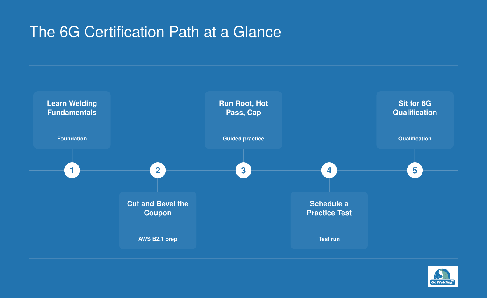

The 6G Certification Path at a Glance
The path to a 6G pipe welding certification is a repeatable five-step process. Treat each step as a checkpoint rather than a suggestion. The goal is not just passing the test, but walking in with a welded coupon you already trust.
Five-step timeline from welding fundamentals through AWS B2.1 6G pipe welding test qualification.
First-time 6G pass rates and the wage bump for certified pipe welders vary widely by program, region, and employer, so verify current numbers yourself. Check BLS.gov wage data, American Welding Society and NCCER certification resources, and your state apprenticeship agency. Then ask program coordinators directly: what is your first-time 6G pass rate, and what do graduates earn?
