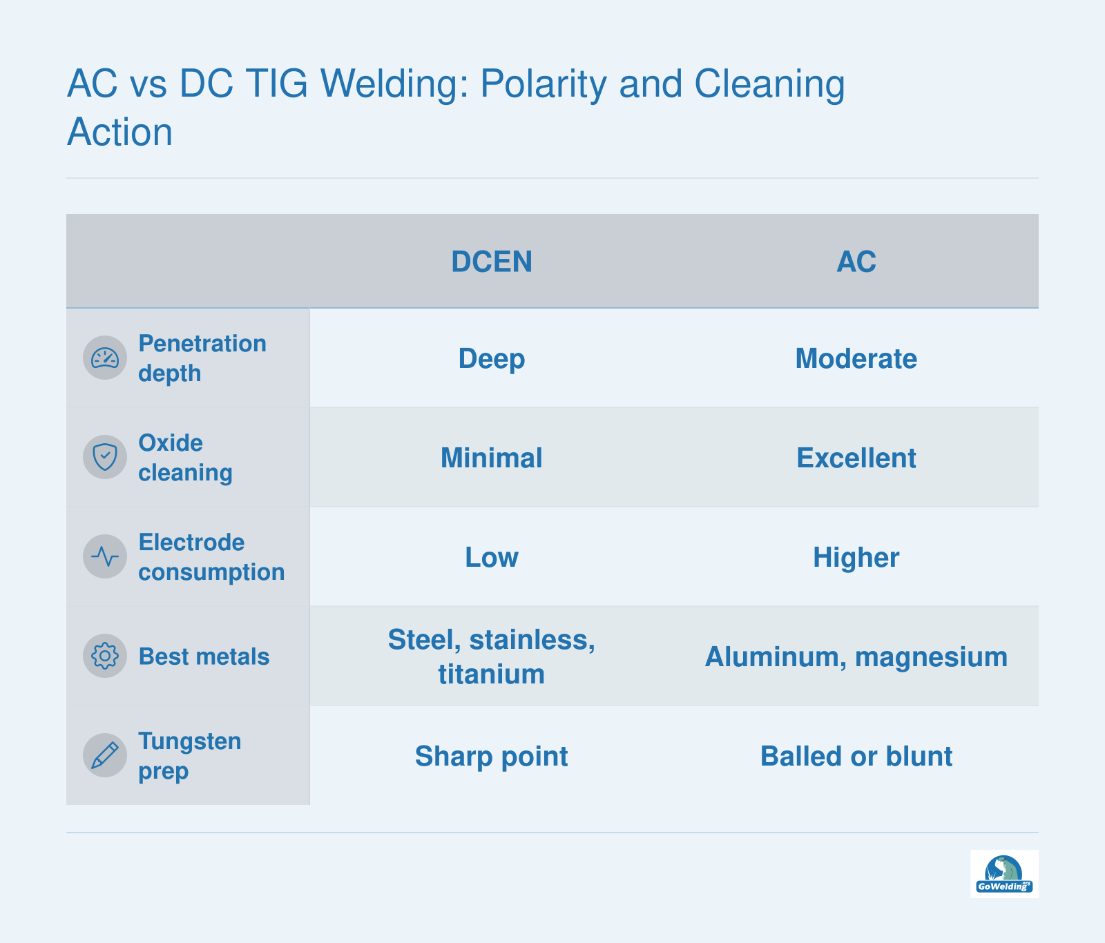

TIG Welding Voltage Type and Welding Polarities
TIG welding just like Stick welding uses the same voltage types. The two Voltage types are:
  • D/C Direct Current like the current from a car battery that only flows in one direction. That is from the (-) negative side to the (+) positive side.
  • A/C Alternating Current like the current in your home. This current changes direction many times a second.
TIG welding just like Stick welding uses two polarity types when welding using Direct Current and they are:
  • DC Direct Current Electrode (-) Negative. This means the electrode or welding handle is the negative side of the circuit and the electricity flows from the TIG torch to the metal.
  • DC Direct Current Electrode (+) Positive. This means that the electrode or welding handle is the positive side of the circuit and the electricity flows from the metal to the TIG torch.
The difference the polarity makes has to do with how much heat is applied to the electrode. D/C electrode (-) negative concentrates about 2/3 of the heat onto the metal welded. This produces a deep penetration weld. D/C electrode (+) positive concentrates about 2/3 of the heat onto the electrode. This produces a shallow weld that is more suitable for sheet metal and at the same time gives the arc characteristics a cleansing action.

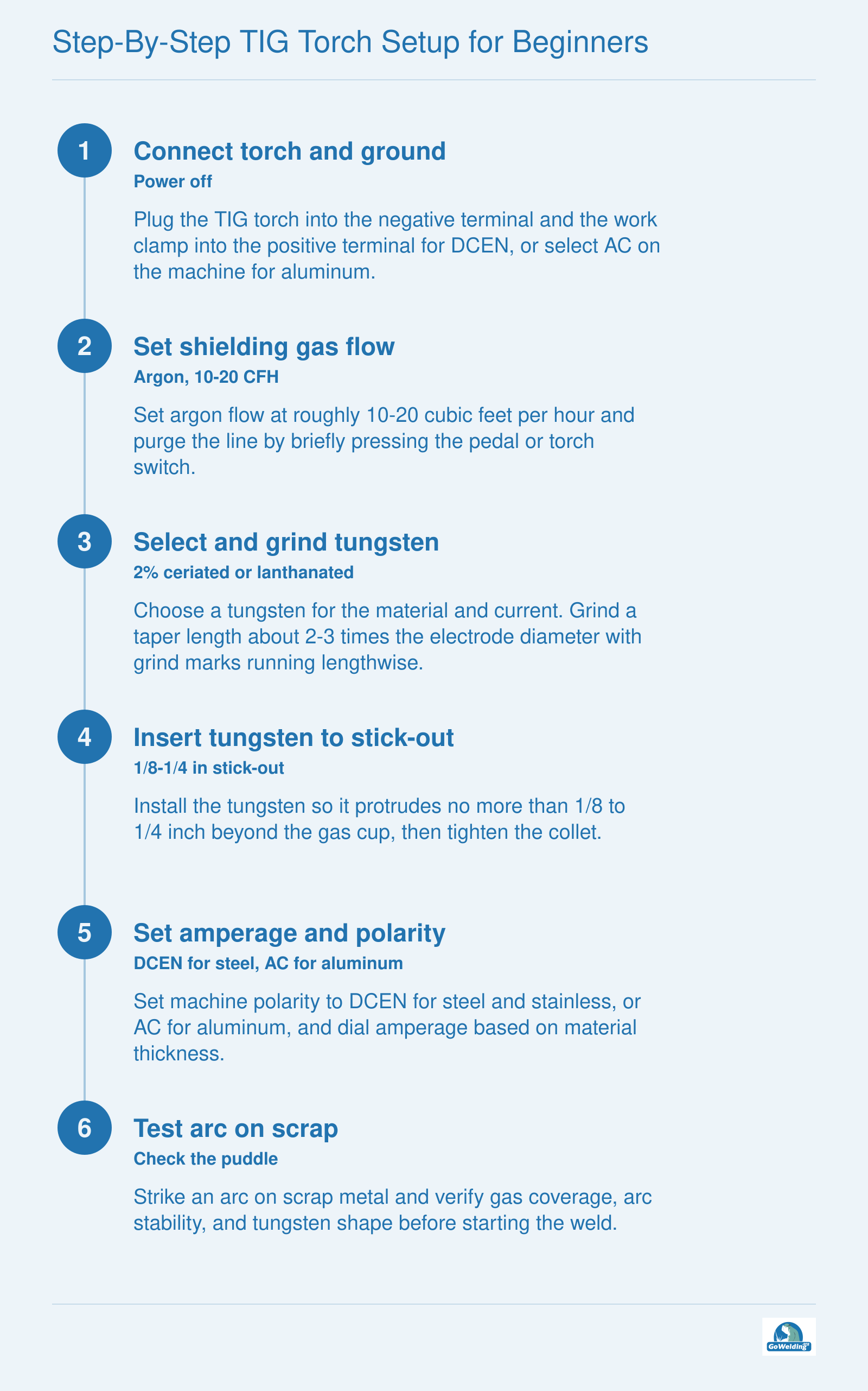

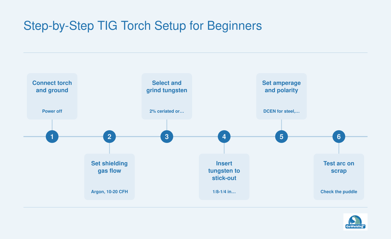

TIG Welding Machine Set-Up
When setting up a TIG welder there are two main settings. They are amperage and gas flow. Amperage settings vary depending on the type and thickness of the metal to be welded. You just set the amperage to a point that you are comfortable with how fast it melts the metal your welding. Gas flow rates also vary depending on draft conditions, cup size, and sometimes the position of the weld. The gas flow rate could range from 5 CFH to 60 CFH for a large cup and drafty conditions. When choosing the gas to weld it is almost always assumed that you will be using pure Argon.
TIG Welder Power Supply Pre Post Flow Settings
Some basic guidelines for machine set-up are as follows:
  • 1/16 Tungsten – Require an amperage rage between 50 to 100 amps. The recommended cup sizes are 4, 5, or 6. Gas flow rate should be between 5 to 15 CFH.
  • 3/32 Tungsten – Require an amperage rage between 80 to 130 amps. The recomendated cup sizes are 6, 7, or 8. Gas flow rate should be between 8 to 20 CFH.
  • 1/8 Tungsten – Require an amperage rage between 90 to 250 amps. The recommended cup sizes are 6, 7, or 8. Gas flow rate should be between 8 to 25 CFH.
Tig Welding Steel
Tig welding steel is very easy. The polarity typically used is DCEN (direct current electrode negative), Argon gas, and Thorium Tungsten. For welding steel and stainless steel the Tungsten needs to be shaped to a fine point.
