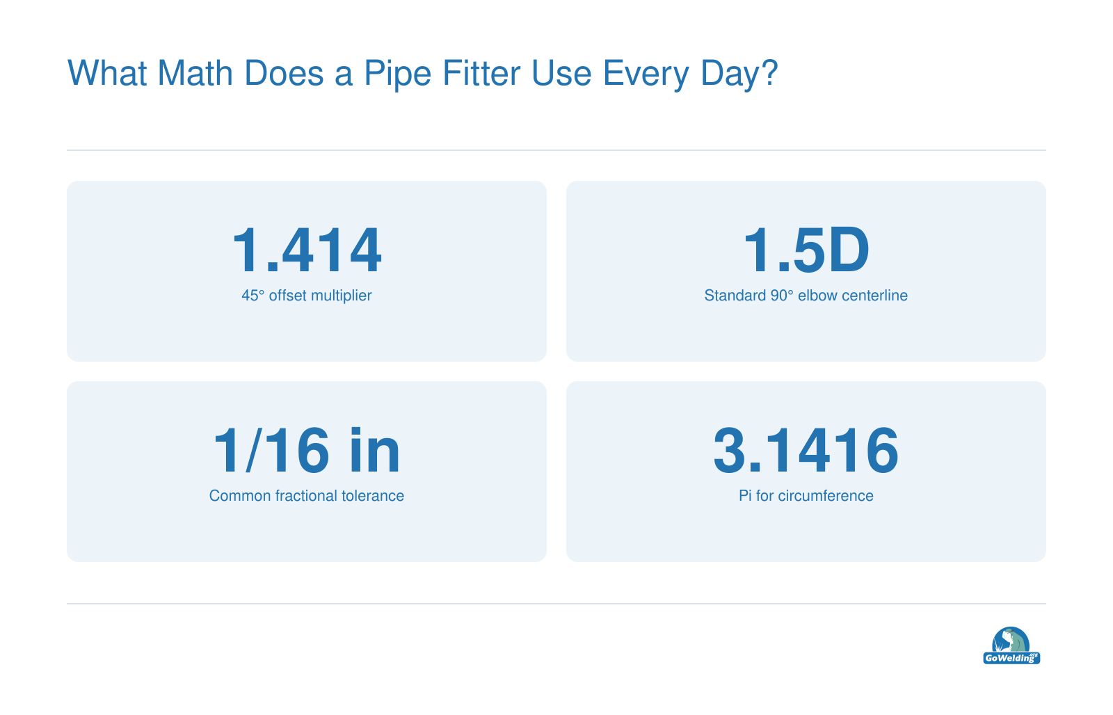

What Math Does a Pipe Fitter Use Every Day?
A pipe fitter's daily math is mostly shop arithmetic and geometry. The same calculations repeat across layout, cutting, and fit-up.
Daily pipe fitter math includes the 1.414 offset multiplier for 45 degree bends, 90 degree elbows with 1.5D centerline radius, 1/16 inch tolerances, and pi for circumference.
