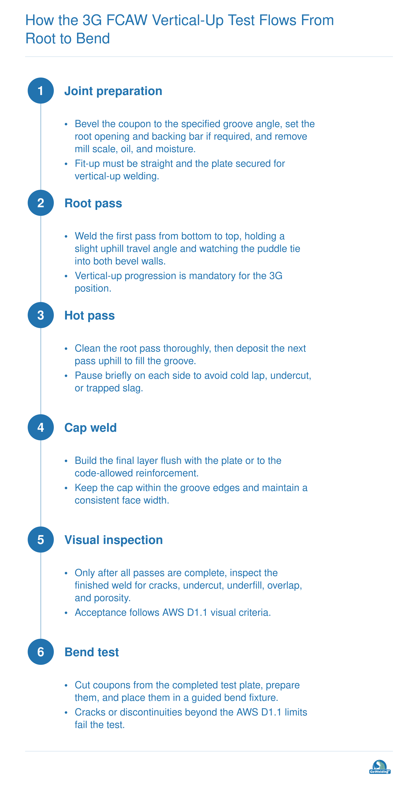

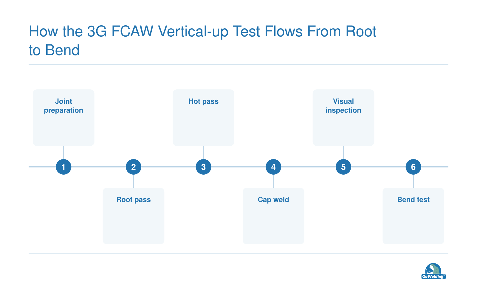

How the 3G FCAW Vertical-up Test Flows From Root to Bend
The 3G flux-cored vertical-up test follows a fixed sequence. All passes are welded uphill, and no inspection starts until the entire weld is complete. Here is the flow from joint preparation to the guided bend test.
Six-step sequence for 3G FCAW vertical-up certification: joint preparation, root, hot, cap, visual inspection, and bend test.
Pass-by-Pass Welding Technique: Root, Hot Pass, and Cap
Vertical-up progression on the 3G plate demands a slow, controlled approach because gravity is fighting your puddle the entire way. Keep the wire in the leading third of the puddle, hold a short stickout of about 1/2 to 3/4 inch for 0.045 to 0.052 inch wire1, and clean thoroughly between every pass. Trapped flux core slag is the single most common between-pass defect, so chip and wire-brush aggressively, paying attention to the toes and tie-ins where slag likes to hide.
Root Pass
Set the electrode at roughly 5 to 15 degrees push from perpendicular; many instructors prefer the steeper end (10 to 15 degrees) to help see the joint and drive the arc into the root. Travel speed is deliberately slow, in the neighborhood of 4 to 7 IPM for 0.045 inch wire, to keep a small, controlled puddle that fuses both bevel faces without sagging. A triangle, J, or chevron weave works well3: the small excursion into each sidewall guarantees fusion, and the return through the center lets the puddle catch up.
For 0.045 inch E71T-1 on thinner practice coupons, a starting envelope of 23 to 25 volts and 200 to 250 IPM wire feed3 is a reasonable reference point, but the actual WPS numbers for 3/8 inch or 1 inch plate come from the qualified procedure, not a generic table.
Hot Pass
After the root is fully deslagged, run the hot pass, Hot Pass Pipe Welding Techniques, with essentially the same 5 to 15 degree push angle. Use a straight bead or a very small weave: the goal is to burn out any remaining slag pockets along the root toes and tie firmly into both sidewalls. If the puddle starts to overheat and droop, pick up travel speed slightly, but not so much that you undercut the toes.
Cap
Clean everything again, then apply Cap Welding Techniques with a controlled weave or triangle pattern3 that fully covers the bevel faces. Pause briefly at each toe to wet in and prevent undercut, then move steadily through the center without dwelling, which would pile up crown. Travel is slightly faster than the fill passes to hold the reinforcement low and uniform. Overall vertical-up travel typically lands in the 8 to 12 IPM range, adjusted by bead appearance.
