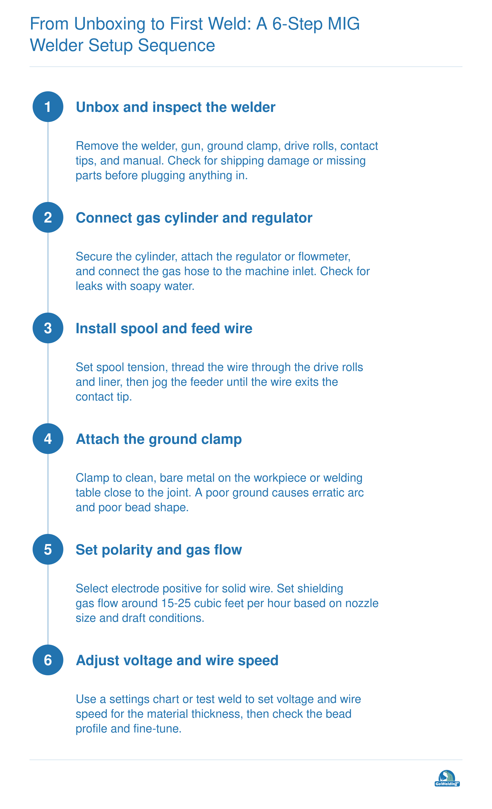

1. Clamp the ground to clean, bare metal on or near the workpiece. 2. Set polarity to DC electrode positive (DCEP) for solid wire with external gas. 3. Open the cylinder and set gas flow, commonly 10 to 15 CFH for solid wire. 4. Dial in voltage and wire feed speed for your material thickness using MIG Welder Settings.
Grounding and surface prep make or break a weld. A poor ground clamp on painted or rusty steel produces erratic arcs and porosity, so grind or wire-brush the connection point and the joint down to clean metal before you begin.

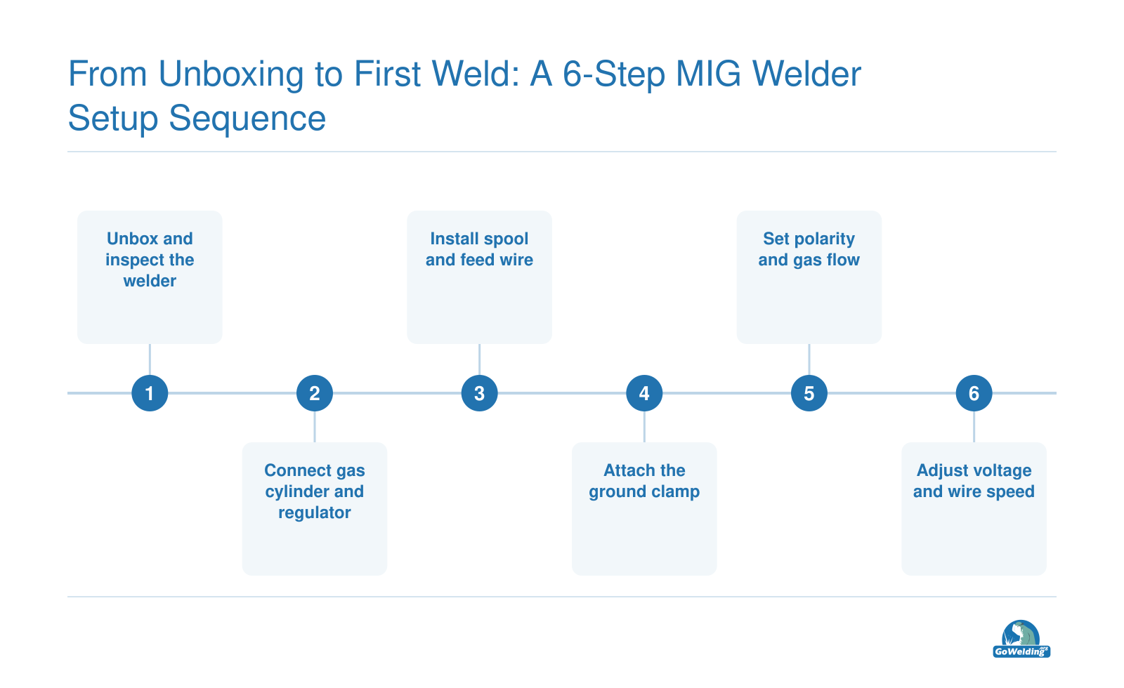

From Unboxing to First Weld: A 6-Step MIG Welder Setup Sequence
A clean setup sequence prevents wire feed problems, gas leaks, and rough starts. Follow these six steps in order before striking your first arc.
