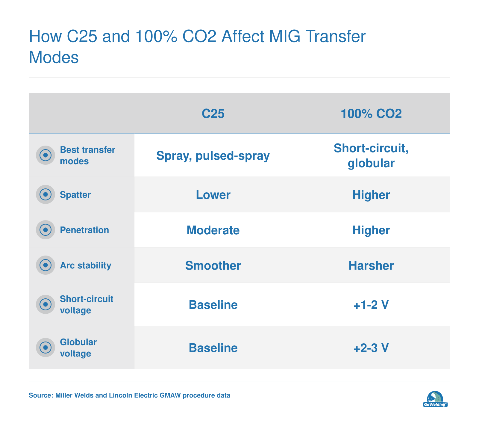

How MIG Welding Gas Effects Arc Transfer Type
Shielding gas choices also effects the weld transfer type. Here are the basics of transfer types related to gasses:
  • Short Circuit transfer requires either pure Carbon Dioxide or a high percentage of Carbon Dioxide.
  • Globular transfer works best with 75% or more Argon in the mixture.
  • Spray transfer depending on the material is also 75% Argon all the way to pure Argon for metals like aluminum.

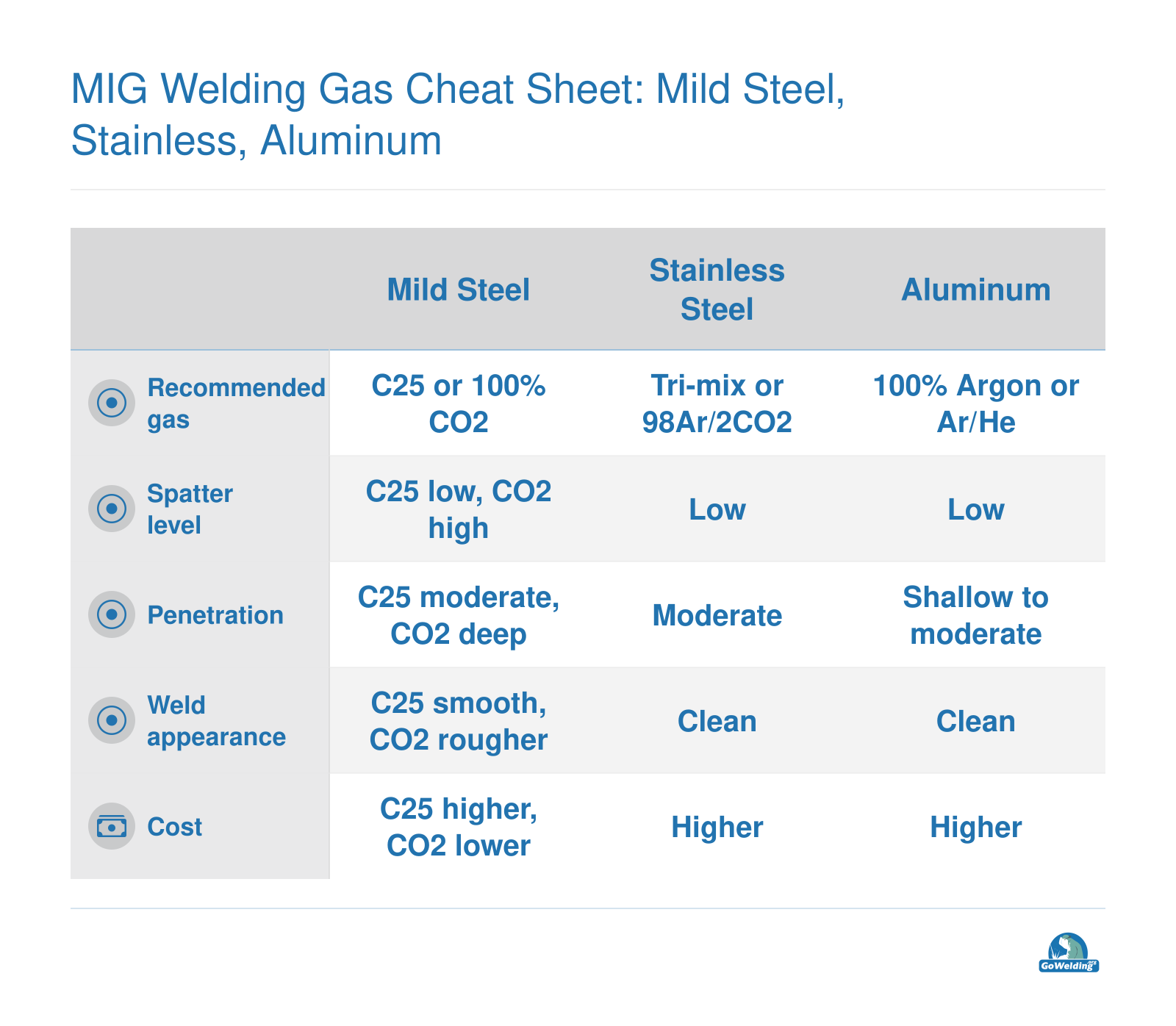

Some basic guidelines for choosing the proper gas are as follows:
MIG Welding Gas for Carbon Steel Welding
Welding of carbon steel can be done with Carbon Dioxide alone and it produces the deepest penetration, the most smoke and the roughest weld. The most widely used mixture is called C25 and that is 25% Carbon Dioxide and 75% Argon gas. There are other mixtures that work well depending on the type of welding that will be done. Most of these are designed by welding gas supply stores and chains. A common mixture is a combination of Argon, Carbon Dioxide and Oxygen.
Carbon Steel MIG Weld done with C25 Gas.
MIG Welding Gas for Stainless Steel Welding
Welding of stainless steel is typically done with C2 or 2% Carbon Dioxide and 98% Argon. In some cases there is tri-mix shielding gas containing 90% Helium, 7.5% Argon, and 2.5%Carbon dioxide. Again many welding supply stores carry their own mixture that can improve the weld quality and ease of welding on stainless steel.
Stainless Steel MIG weld done with C2 gas.
MIG Welding Gas for Aluminum Welding
Welding of aluminum is typically done with Argon alone, with one exception. If the aluminum being welded is thicker than ½ of an inch there may be Helium added to the mix.
Aluminum MIG Weld done with Argon gas
