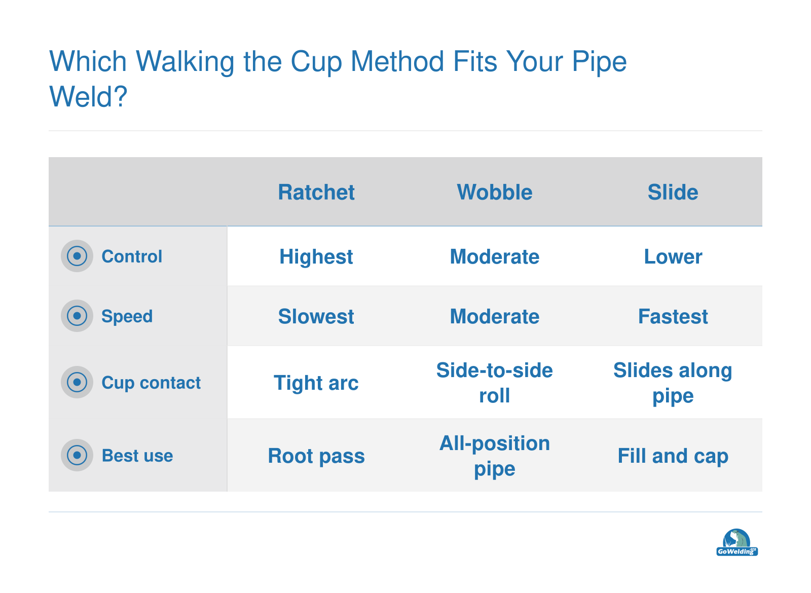

How to Walk the Cup: Ratchet, Wobble, and Slide Methods
The three cup-walking methods in TIG Welding trade control for speed: tighter motion yields a slower, more precise bead; looser motion moves faster but risks undercut or an uneven crown. Most pipe welders use all three in a single joint, matching the method to the pass.
Ratchet: Best for Root Control
Ratchet is a stop-and-go rhythm built for narrow, unforgiving root passes. Rest the cup edge on one bevel face, pause, let the puddle wet in, then rock the cup to the opposite face with a short wrist twitch, pause again, and reverse. Each pause is where filler gets dabbed into the leading edge of the puddle, so the cadence becomes: pause, dab, rotate, pause, dab, rotate. Because the motion is small and deliberate, ratchet gives the tightest control over keyhole size, which is why it dominates root pass work where a #6 cup and a 1/16 to 3/32 inch root opening leave very little room for error.
Wobble: Coverage Over Precision
Wobble trades that precision for coverage. Instead of resting and lifting, the cup stays down and rocks continuously side to side while sliding forward, never fully pausing on either bevel. This continuous rock spreads heat across a wider path in less time, which is useful once you are past the root and need to cover more surface area quickly. Filler timing shifts too: rather than dabbing at a fixed pause point, you feed the rod in a steady rhythm timed to the rock, adding metal on each side-to-side cycle rather than at a dead stop. Wobble works best with larger cups, often #7 or #8, since the technique assumes a wider, more stable resting surface.
Slide: Built for Hot Pass and Fill
Slide keeps the cup in constant contact with both bevel faces and moves it laterally with minimal arc length change, almost skating it across the groove. There is little to no rocking, just a smooth lateral traverse that reverses direction at each bevel edge. This method suits hot pass welding, where a #7 cup can travel without binding, and the fill passes, where a #7 or #8 cup can travel without binding; in both, a stable, flatter arc length matters more than tight puddle manipulation.
Torch Angle and Filler Across All Three
Regardless of method, hold roughly a 90 degree work angle with a 15 to 20 degree push travel angle, tilting the torch 5 to 15 degrees off vertical to maintain visibility and access around the pipe curvature. Filler stays consistent in diameter, often 1/8 inch, but timing changes: dab-and-pause for ratchet, continuous feed for wobble, and steady lateral feed for slide.
Which Walking the Cup Method Fits Your Pipe Weld?
Walking the cup changes how the TIG torch moves and where the cup contacts the pipe. Choose a method based on the joint position, your control preference, and the pass you are welding. The three main methods are ratchet, wobble, and slide.
Comparison of ratchet, wobble, and slide walking the cup methods across control, speed, cup contact, and best use.
