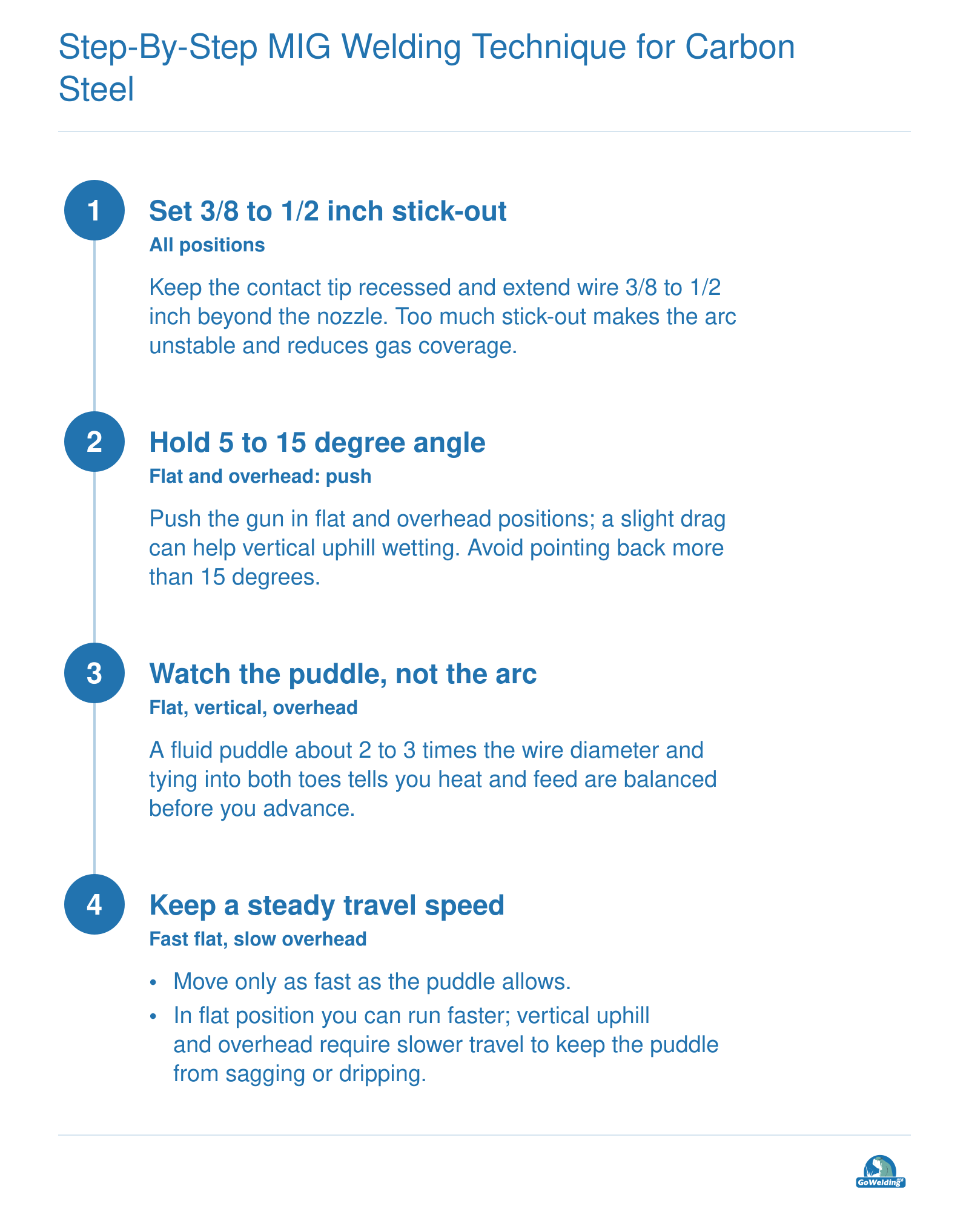

Step-by-Step MIG Welding Technique for Carbon Steel
Good MIG technique comes down to controlling four variables at once: stick-out, travel angle, puddle shape, and travel speed. Use this sequence as a mental checklist before and during each pass.
In many carbon steel welding procedures, the carbon equivalent (CE) value is the trigger for preheat. Once CE climbs above about 0.40, preheating is strongly recommended because faster weld cooling can trap hydrogen and cause cracking. The same joint preparation guidance referenced in this guide uses that threshold as a practical cutoff for mild and low alloy steels.
