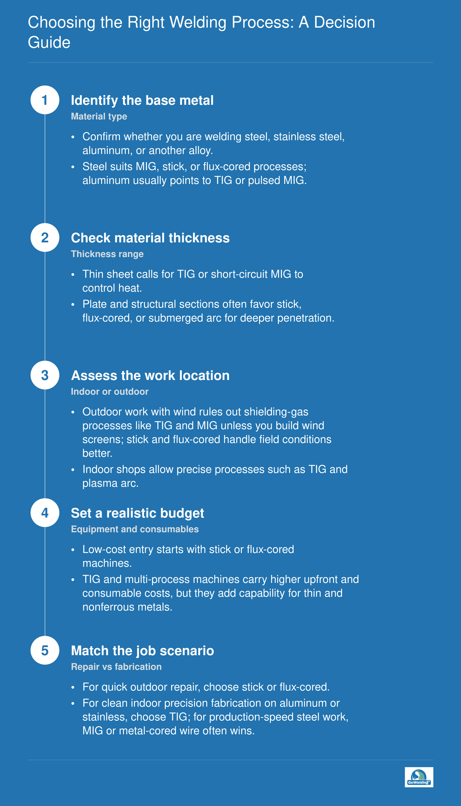

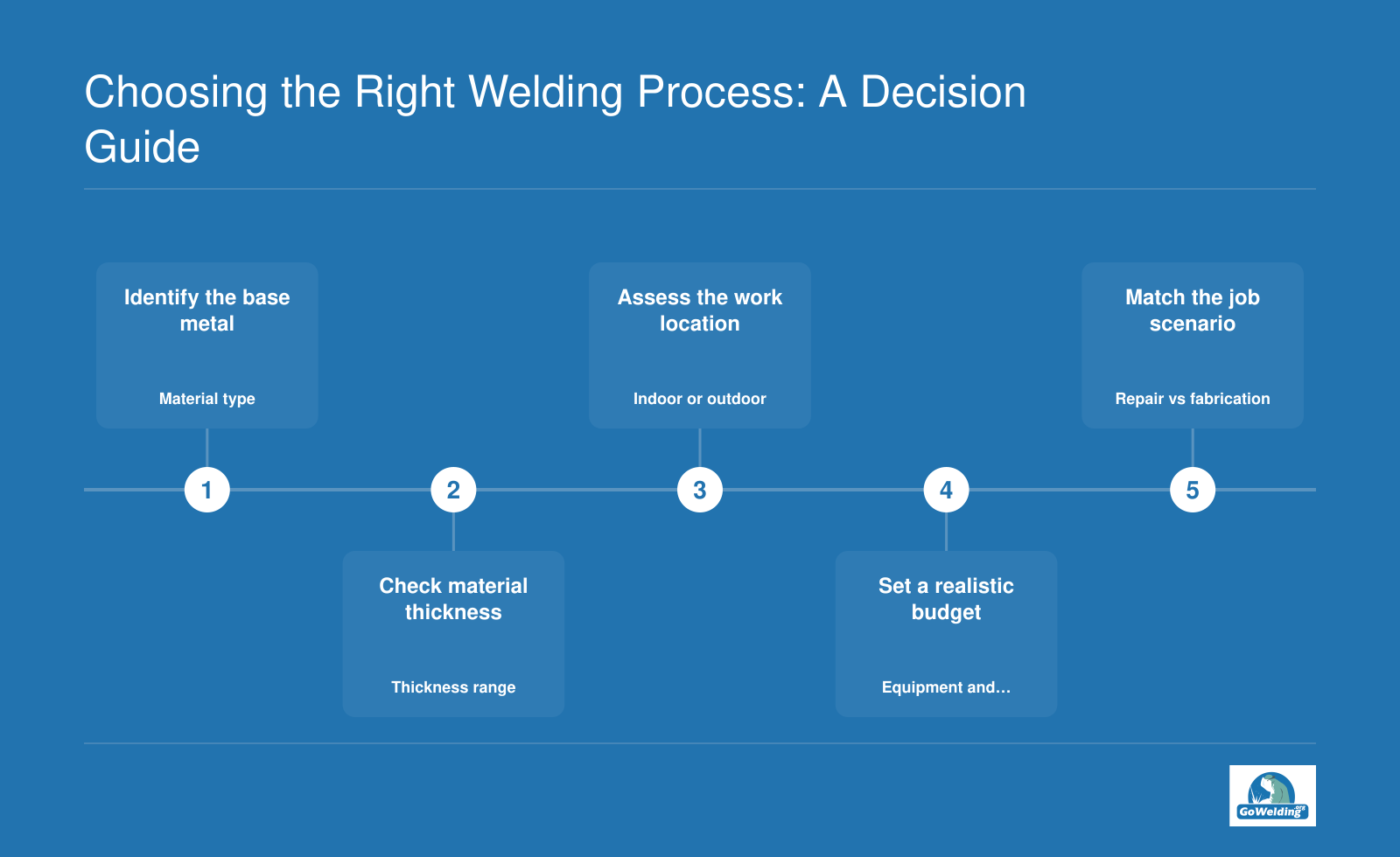

Choosing the Right Welding Process: A Decision Guide
Start with what you are joining and how thick it is, then narrow by where the work happens and what you can spend. Use the final scenario check to confirm your process choice against real repair or fabrication needs.
Picking a first process and mastering a specialty are two very different problems.
Welding splits into three physical categories: fusion (arc, gas, high-energy beam), pressure (resistance, solid-state), and brazing or soldering. Inside fusion, the arc family carries most day-to-day work, with stick, MIG, flux-cored, and TIG Welding doing the heavy lifting and plasma, submerged arc, and electroslag handling specialized jobs. Matching the process to base metal, thickness, and setting matters more than chasing the newest machine.
If you are starting out, MIG Welding is the easiest to learn on thin steel, and stick is the most forgiving in the field. From there, revisit the safety and certification sections to plan your training path and pick a credential that matches the work you actually want to do.
