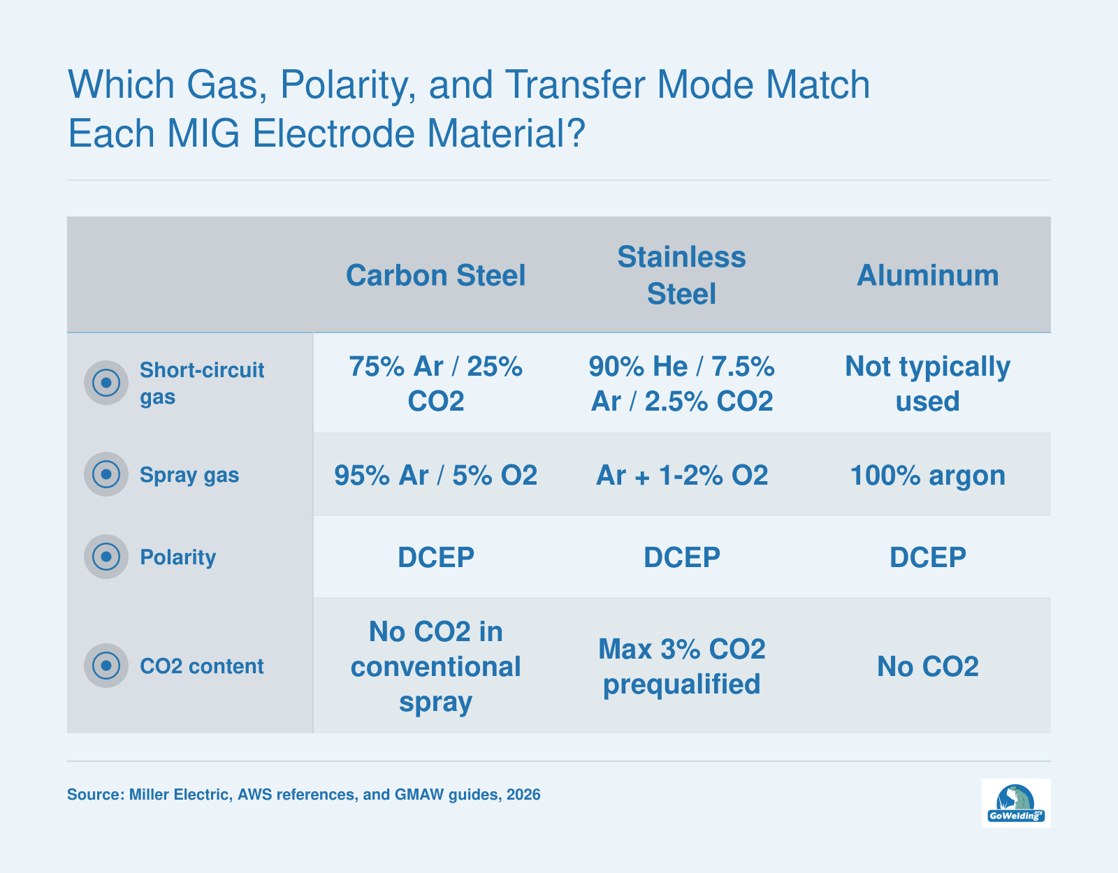

Which Gas, Polarity, and Transfer Mode Match Each MIG Electrode Material?
Solid-wire GMAW runs DCEP for carbon steel, stainless steel, and aluminum. The gas mixture and transfer mode change the weld characteristics, so match them to the base metal and the procedure you are running.
