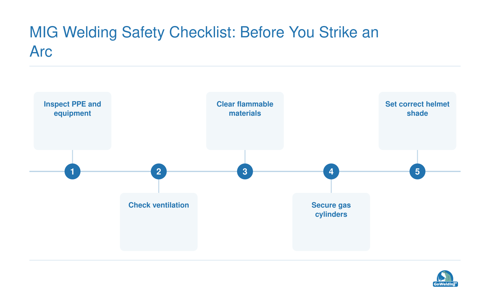

MIG Welding Safety Checklist: Before You Strike an Arc
Run through this sequence every time before you strike an arc, even for a quick tack weld. It takes under two minutes and prevents most MIG injuries.
Five pre-weld safety checks in order: PPE, ventilation, clear flammables, secure gas cylinders, set helmet shade 10 to 11.
