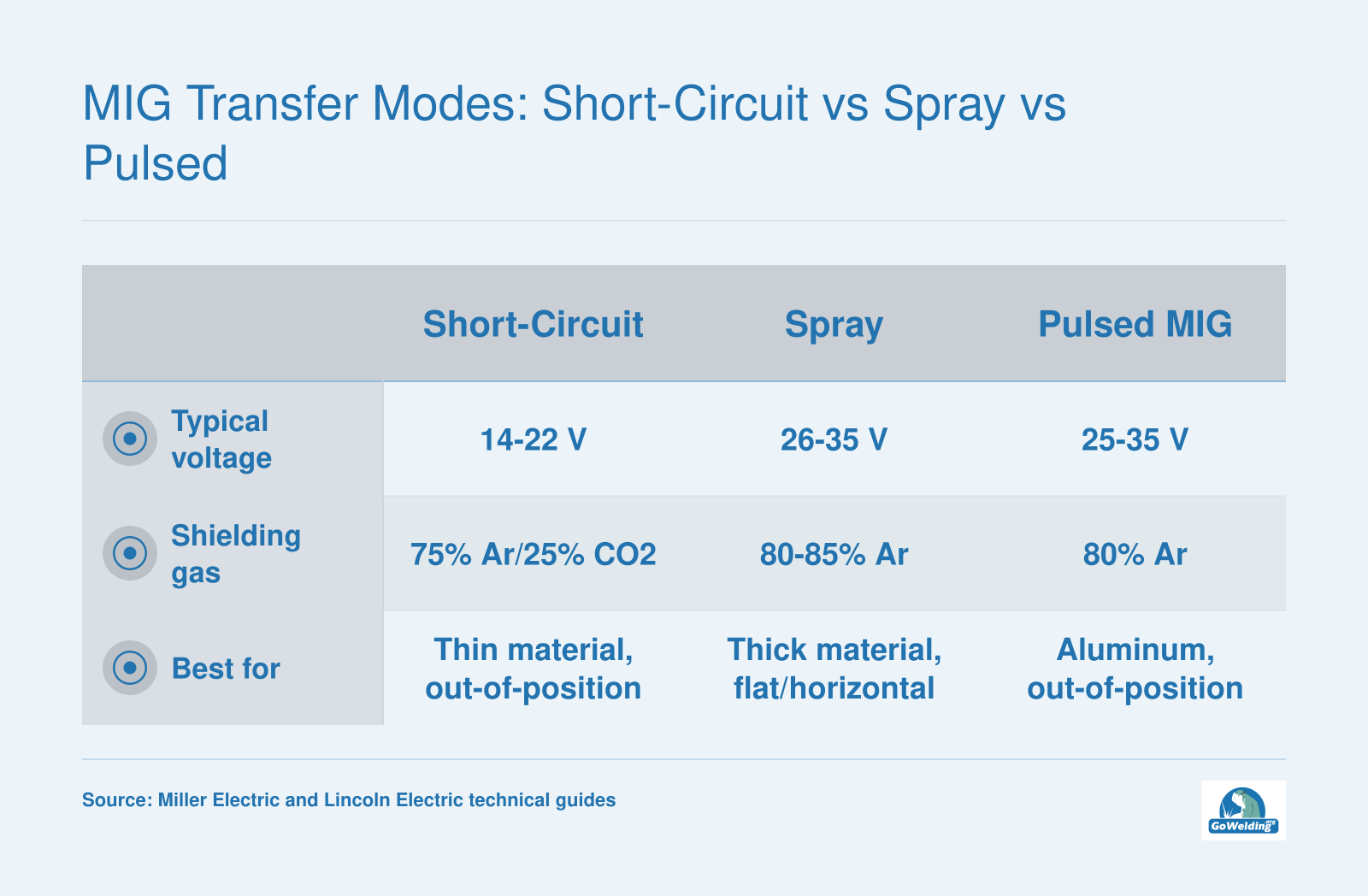

MIG Transfer Modes: Short-Circuit vs Spray vs Pulsed
The transfer mode controls how the wire melts into the weld pool. Short-circuit is the low-heat workhorse for thin and out-of-position work, spray gives high deposition on thick material in flat or horizontal positions, and pulsed MIG delivers spray-like control with less heat, especially for aluminum and out-of-position welding.
Comparison of MIG transfer mode voltage ranges, shielding gas mixes, and best applications for short-circuit, spray, and pulsed MIG.
