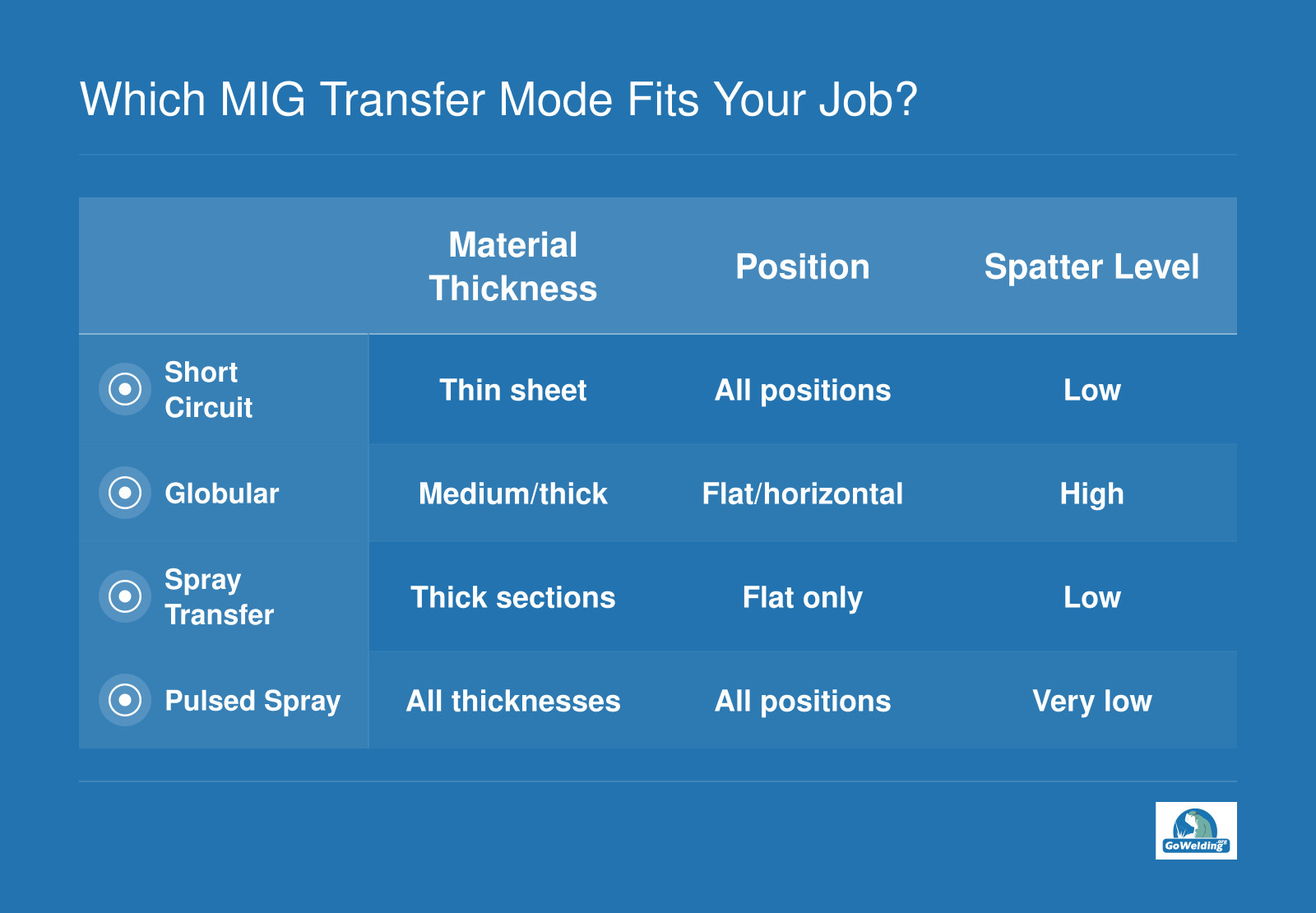

Which MIG Transfer Mode Fits Your Job?
Match the mode to the metal. Short circuit suits thin sheet and out-of-position joints, globular is a high-spatter transitional mode, spray delivers high deposition on thick flat work, and pulsed spray offers spray-like productivity with less heat and spatter. The card below shows the three quickest filters: material thickness, usable positions, and spatter level.
