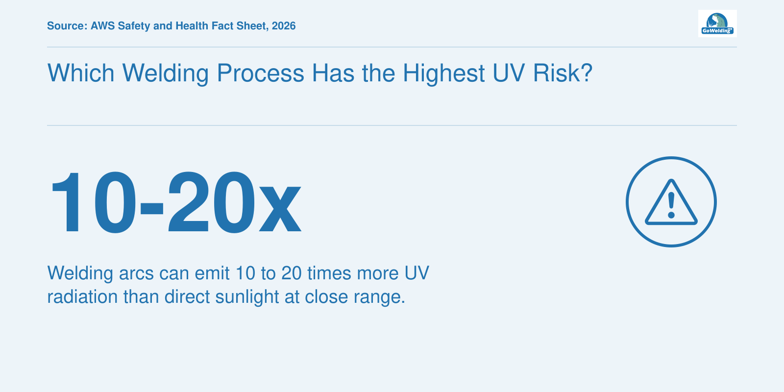

Which Process Puts Out the Most UV?
Not all Welding Processes carry equal skin risk. MIG Welding/GMAW consistently ranks highest for UV output. A widely cited 1985 review found MIG could force a maximum safe unprotected exposure of under one second at one meter, versus roughly ten seconds for stick (SMAW) and TIG (GTAW) at typical currents. Flux-cored (FCAW) welding is grouped in the same high-risk category as MIG. Aluminum TIG Welding deserves special mention: measured actinic UV irradiance for aluminum TIG has run from about 7.8 to 37.6 watts per square meter, notably intense for a process often assumed to be gentler than MIG.1
Where the Limits Come From
OSHA and the EU's SCHEER panel both set an effective 8-hour UV exposure limit around 30 joules per square meter, with a separate, much higher UV-A allowance near 10,000 joules per square meter, reflecting how much less damaging that band is per unit of energy. ACGIH publishes comparable eye and skin thresholds. These numbers exist because arc UV, unlike sunlight, can exceed a full day's safe dose in seconds.
Which Welding Process Has the Highest UV Risk?
Stick (SMAW) and flux-cored arcs generally produce the most intense ultraviolet radiation, followed by MIG (GMAW). TIG (GTAW) tends to emit the lowest UV of the four, but every process can burn exposed skin in seconds and demands full coverage.

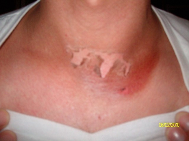

Welding Sunburn vs. Thermal Burns: Spotting the Difference
Welding sunburn and thermal burns look similar at first but differ in how quickly they appear, how deep they go, and where they show up. The American Burn Association classifies thermal burns by depth, while UV burns from welding arcs typically follow a sunburn-like pattern on exposed skin. Use this side-by-side comparison to tell them apart before choosing first aid.
| Aspect | Welding Sunburn (UV Radiation Burn) | Thermal or Contact Burn |
| Cause | Unprotected ultraviolet radiation from the welding arc damages skin cells, much like intense sun exposure. | Direct heat from flame, hot metal, sparks, or flash produces immediate skin injury at the contact point. |
| Appearance | Red, inflamed, dry or blistered skin that resembles sunburn; peeling may follow in days. | Superficial burns are red and dry; deeper burns may blister, swell, or become white, charred, or leathery. |
| Depth | Usually superficial (first-degree) involving the outer skin layer; prolonged exposure can cause partial-thickness (second-degree) damage. | May be first-degree (superficial), second-degree (partial thickness), or third-degree (full thickness) based on American Burn Association criteria. |
| Typical locations | Exposed skin: face, neck, ears, forearms, and the V of the chest, wherever PPE left skin uncovered. | Contact or flash points: hands, wrists, forearms, lower legs, or any body part touched by hot metal, flame, or ignited clothing. |
| Pain onset | Often delayed for hours after exposure, then becomes sore and tender, like a sunburn. | Usually felt immediately at the time of injury; deep full-thickness burns may feel numb because of nerve damage. |
| First aid | Cool compresses, aloe or moisturizer, over-the-counter pain relief, and avoiding further arc exposure; see medical care for large blisters or severe pain. | Cool running water for superficial burns, cover with clean dressing, do not apply ice or grease; referral to a burn center for blistered, charred, leathery, or numb larger burns. |

How to Treat Welding Sunburn at Home (First Aid)
A welding sunburn is a UV radiation burn to exposed skin from the arc, similar to a strong sunburn. When only the top layer of skin is affected and there are no blisters, you can usually manage the injury at home with simple first aid.
Cool and Soothe the Skin
Start by cooling the area. Apply a cool, wet compress, or take a cool bath or shower for about 10 minutes, several times a day.1 Pat the skin dry instead of rubbing. After cooling, apply a gentle moisturizer or aloe vera. Calamine lotion or a colloidal oatmeal bath can also help calm itching and discomfort.2 Avoid products that contain alcohol, which can sting and dry the skin.1
Do not put ice directly on burned skin.1 Ice can cause additional tissue damage. Butter and toothpaste are also unsafe home remedies: butter holds heat and can increase infection risk, and toothpaste does not help a burn. Keep clothing loose over the area so it does not rub.
Manage Blisters Carefully
A blister means the burn is at least second-degree, not a mild first-degree burn.2 Leave blisters intact. Do not pop them.2 An intact blister protects healing skin from infection. If skin is unbroken, a plain moisturizer is enough. If a blister breaks, clean gently with mild soap and water and cover with a nonstick sterile bandage.1 A petroleum jelly2 or antibiotic ointment1 may be used on broken skin, but topical antibiotics can irritate or cause allergic reactions in some people.
