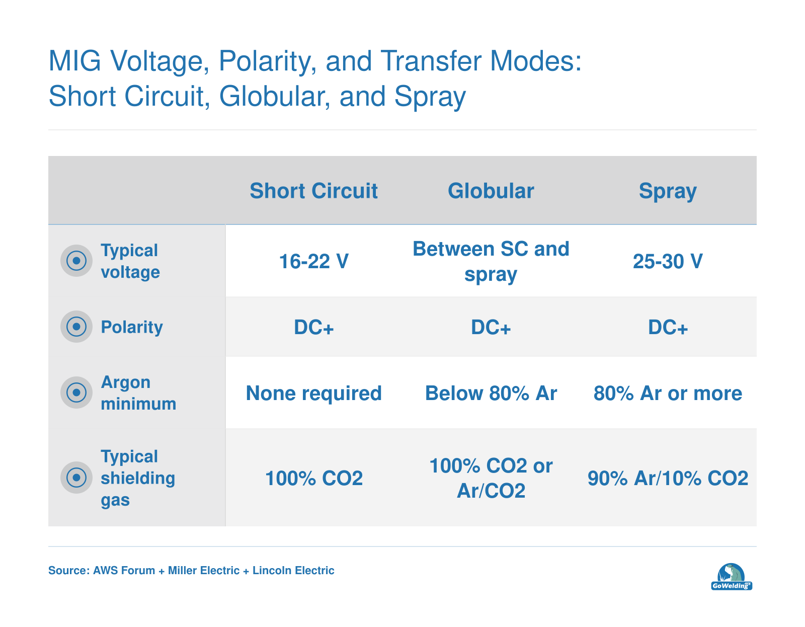

MIG Voltage, Polarity, and Transfer Modes: Short Circuit, Globular, and Spray
MIG transfer mode is set by voltage, wire feed speed, and shielding gas, not by a single dial. The values below are typical starting points, not universal thresholds; always verify with a test coupon.
MIG transfer modes compared: short circuit 16-22 V, globular between short circuit and spray, spray 25-30 V, all DC+ polarity.

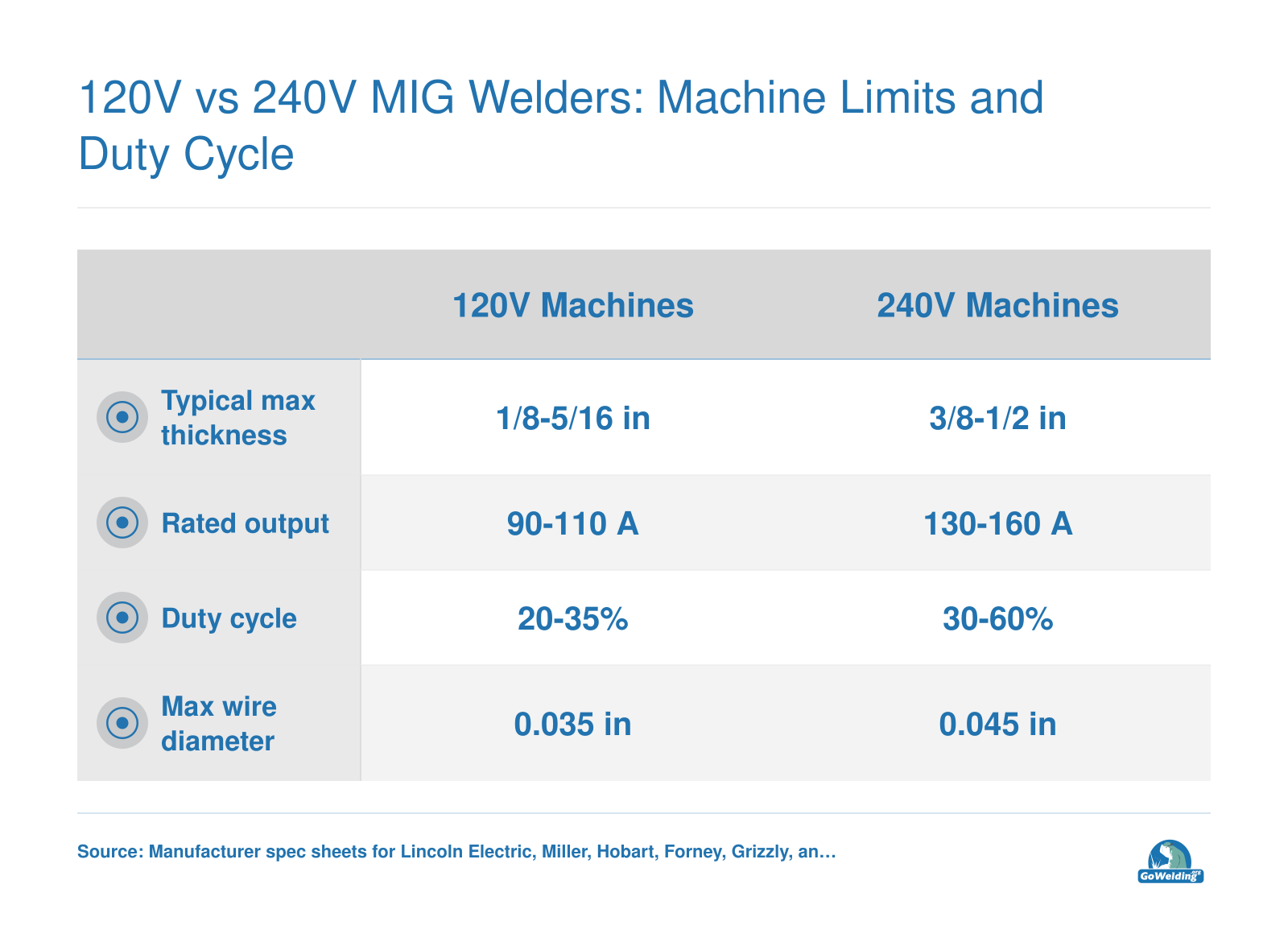

120V vs 240V MIG Welders: Machine Limits and Duty Cycle
For homeowner and dual-voltage machines, input voltage sets the ceiling. 120V models typically top out at 90-110 amps, while their 240V counterparts reach 130-160 amps. Duty cycle and wire diameter follow the same pattern.
