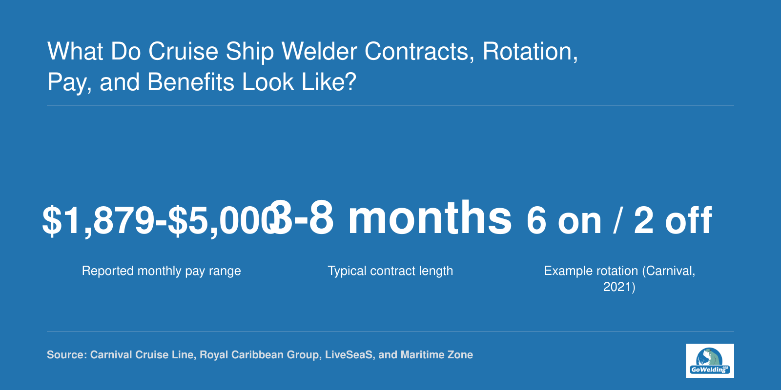

What Do Cruise Ship Welder Contracts, Rotation, Pay, and Benefits Look Like?
Contract terms vary by cruise line and position, but most assignments run several months with unpaid time off between contracts. Cruise lines generally cover room, board, travel to the ship, and onboard medical care; overtime rates are not consistently published in the sources reviewed.
Cruise ship welder pay range of $1,879 to $5,000 monthly, contracts of 3-8 months, and a 6 on / 2 off rotation example.

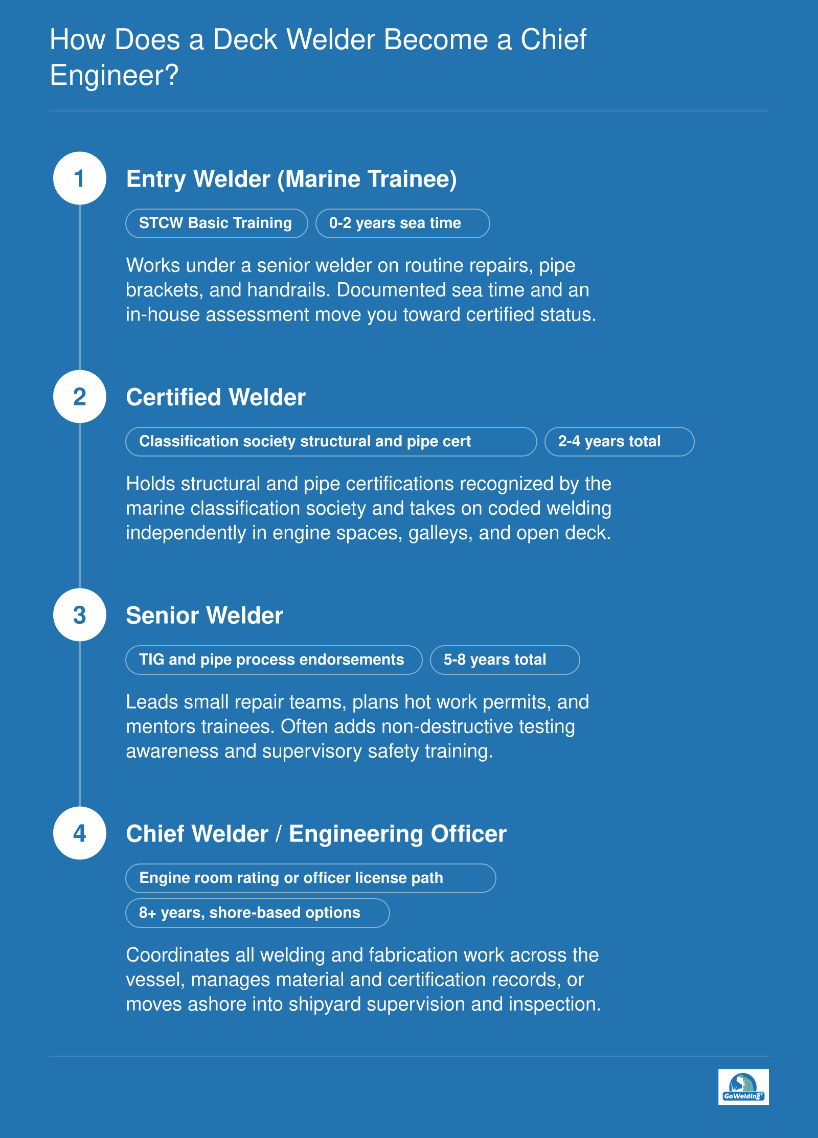

How Does a Deck Welder Become a Chief Engineer?
Advancement in cruise ship welding follows a credential and sea-time ladder rather than a single promotion. Most welders move from supervised repairs to coded welding, then into lead and engineering officer roles or shore-side supervision.
Four-stage marine welding career path from entry trainee to chief engineer, with typical timelines and credentials.
A cruise ship welding job asks for real credentials: AWS or equivalent coded welding tickets (including 3G SMAW Certification and 6G Pipe Welding), STCW basic safety training, documented shipyard or marine repair experience, a valid seafarer medical, and the physical fitness to work in tight, hot spaces at sea. In return, contracts bundle wages with free room, board, travel, and medical care, which makes total compensation competitive with land jobs even when the day rate looks similar.
