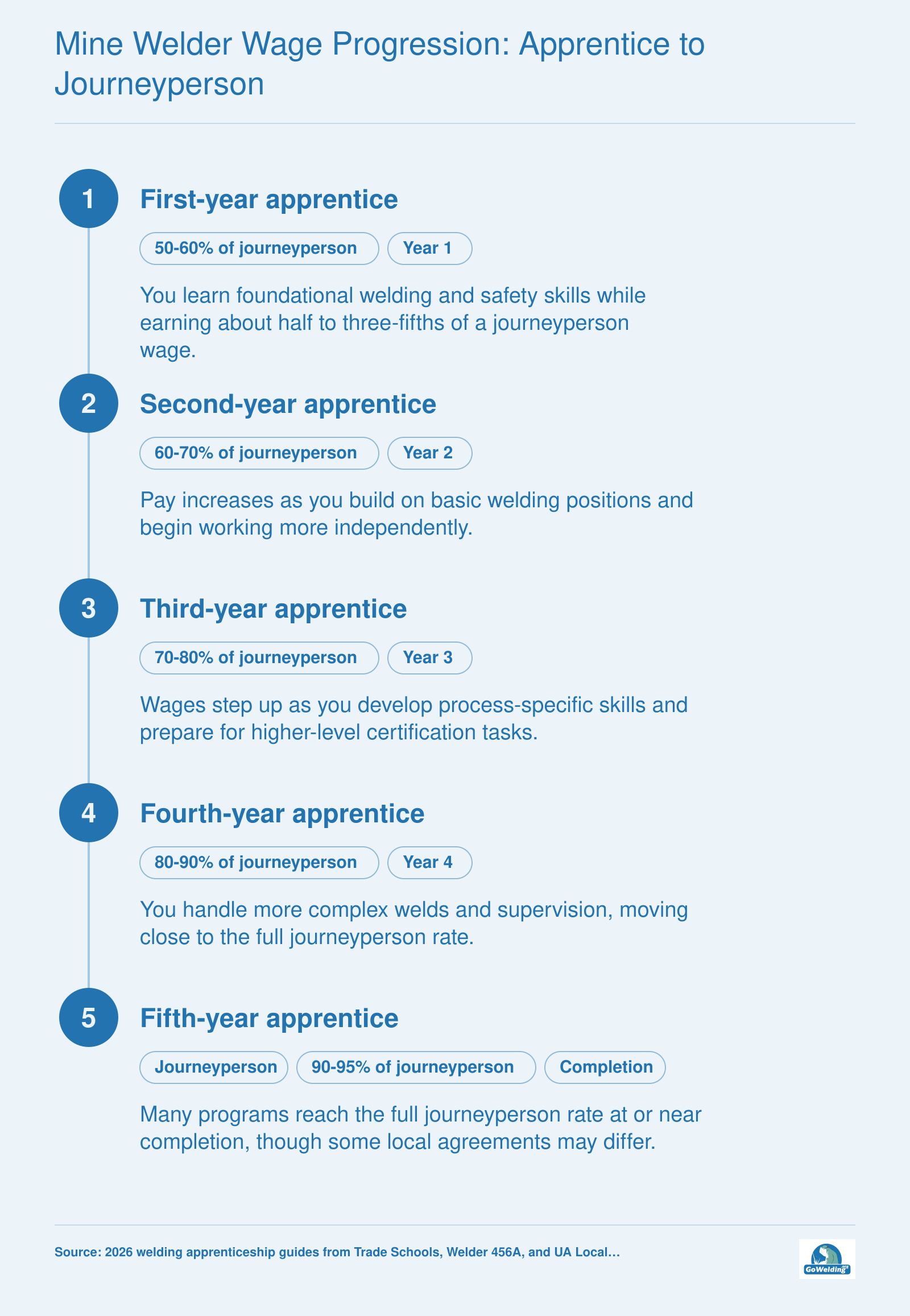

Mine Welder Wage Progression: Apprentice to Journeyperson
Apprentice pay is usually set as a percentage of the journeyperson rate. These ranges reflect common 2026 industry benchmarks, while specific union agreements and mine sites can differ. Underground, remote, and camp premiums vary by contract and are not uniformly published.
Welder apprentice wages as a percentage of journeyperson rate from year 1 through year 5 in 2026.
