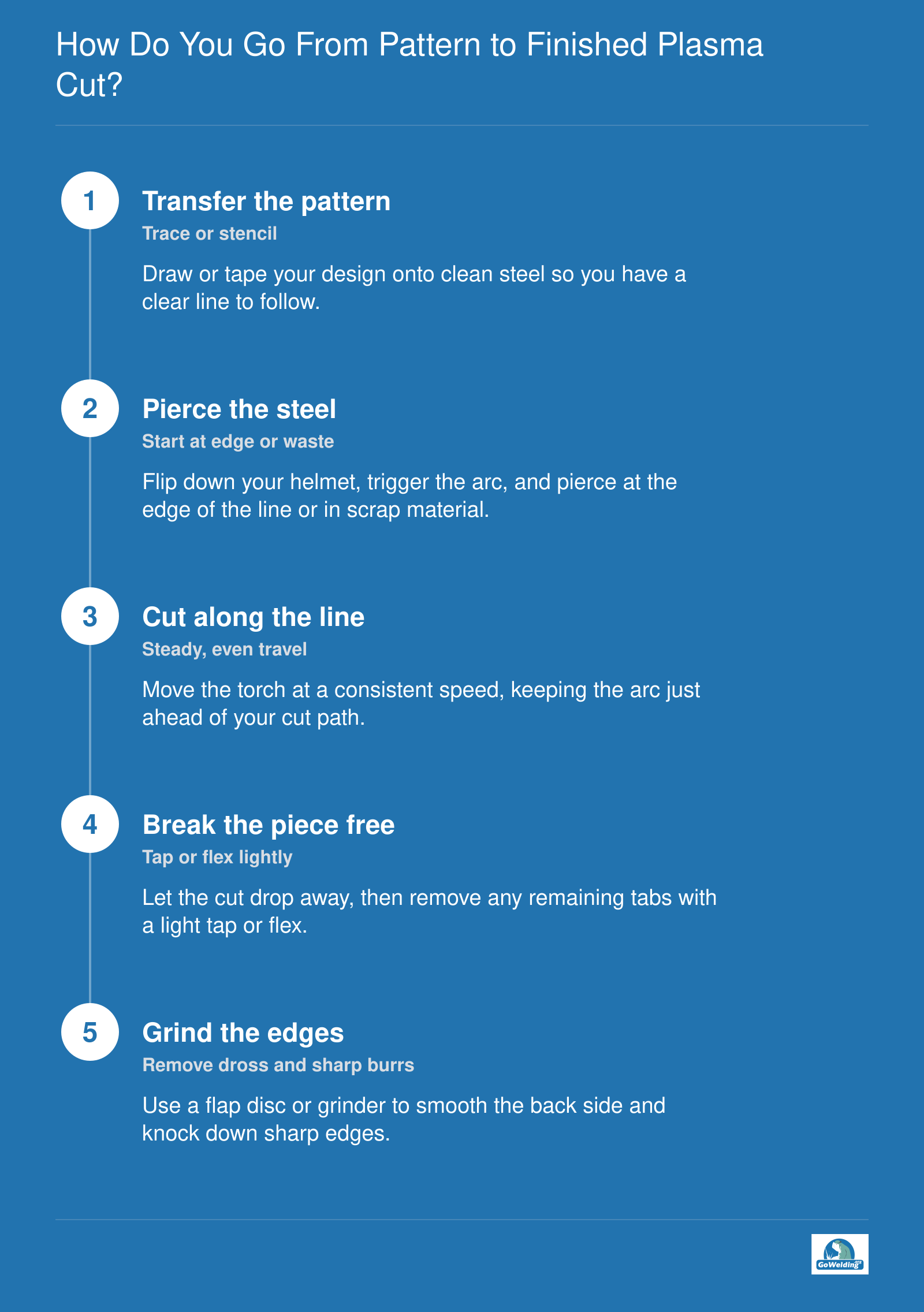

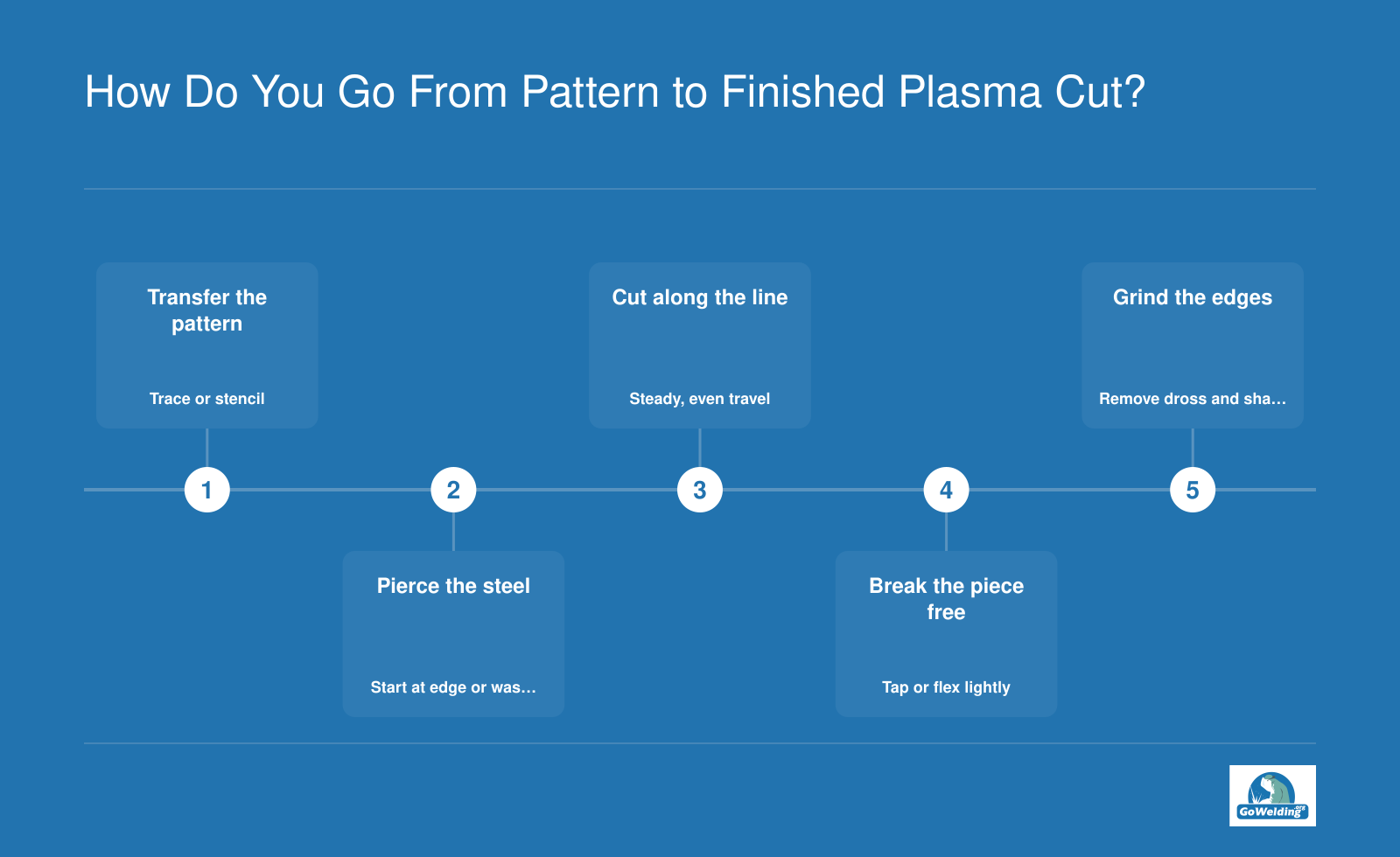

How Do You Go From Pattern to Finished Plasma Cut?
Here's the basic five-step sequence for freehand plasma cutting. Clean pattern transfer and a controlled pierce make the cut itself much easier.
Five-step freehand plasma cutting sequence from pattern transfer to edge grinding
