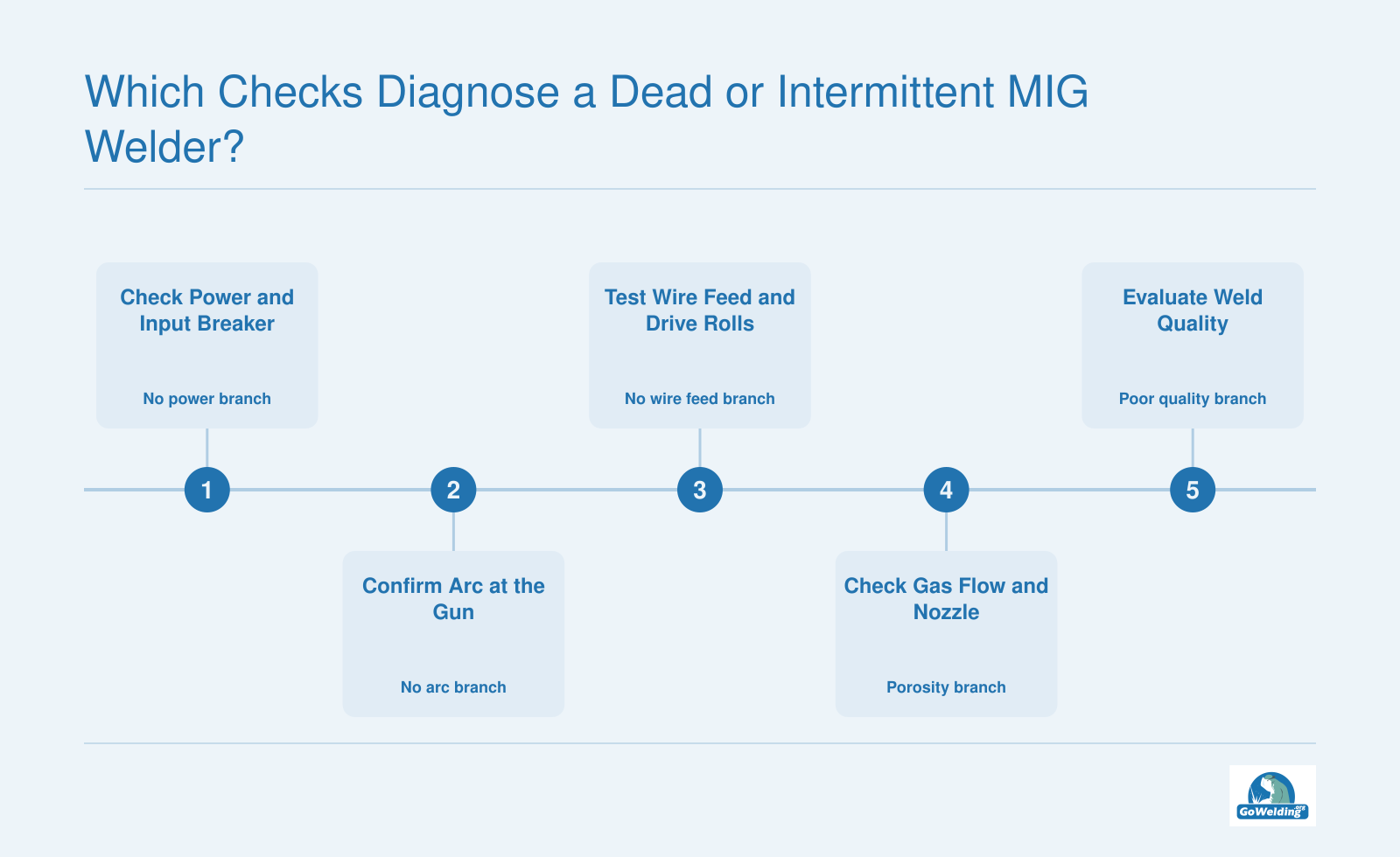

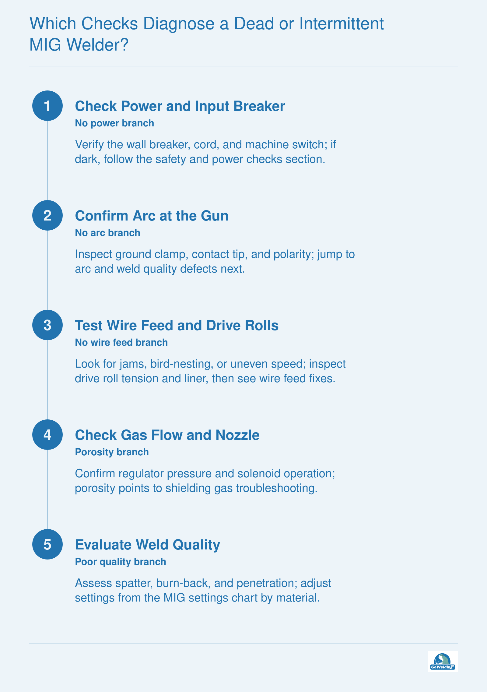

Which Checks Diagnose a Dead or Intermittent MIG Welder?
Work through these five checks in order: power, arc, wire feed, gas flow, then weld quality.
Five-step diagnostic sequence for MIG welder issues: check power, arc, wire feed, gas flow, and weld quality.
