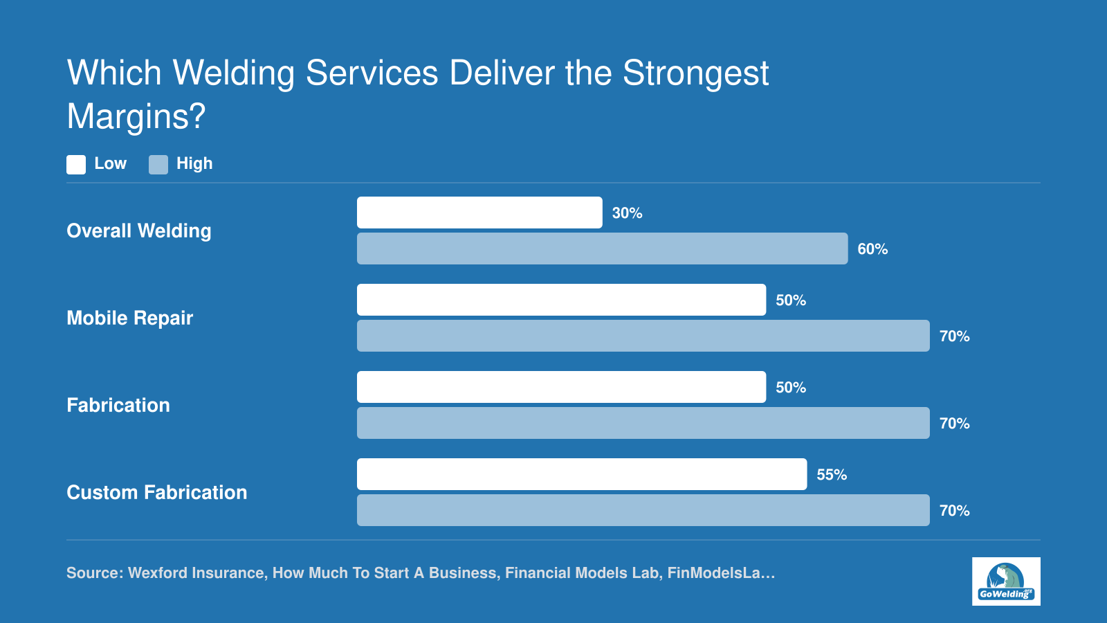

Which Welding Services Deliver the Strongest Margins?
Margins vary widely by service type, and published benchmarks are estimates rather than formal trade-association data. In general, mobile repair and custom fabrication command higher gross margins because they price for convenience, speed, and design complexity, while commodity structural work often competes on rate alone. Structural welding is excluded from this chart because the available benchmarks focus on hourly rates and markup multipliers rather than a consistent gross margin.
Gross margin ranges for welding services in 2026: overall 30-60%, mobile repair 50-70%, fabrication 50-70%, custom fabrication 55-70%.
