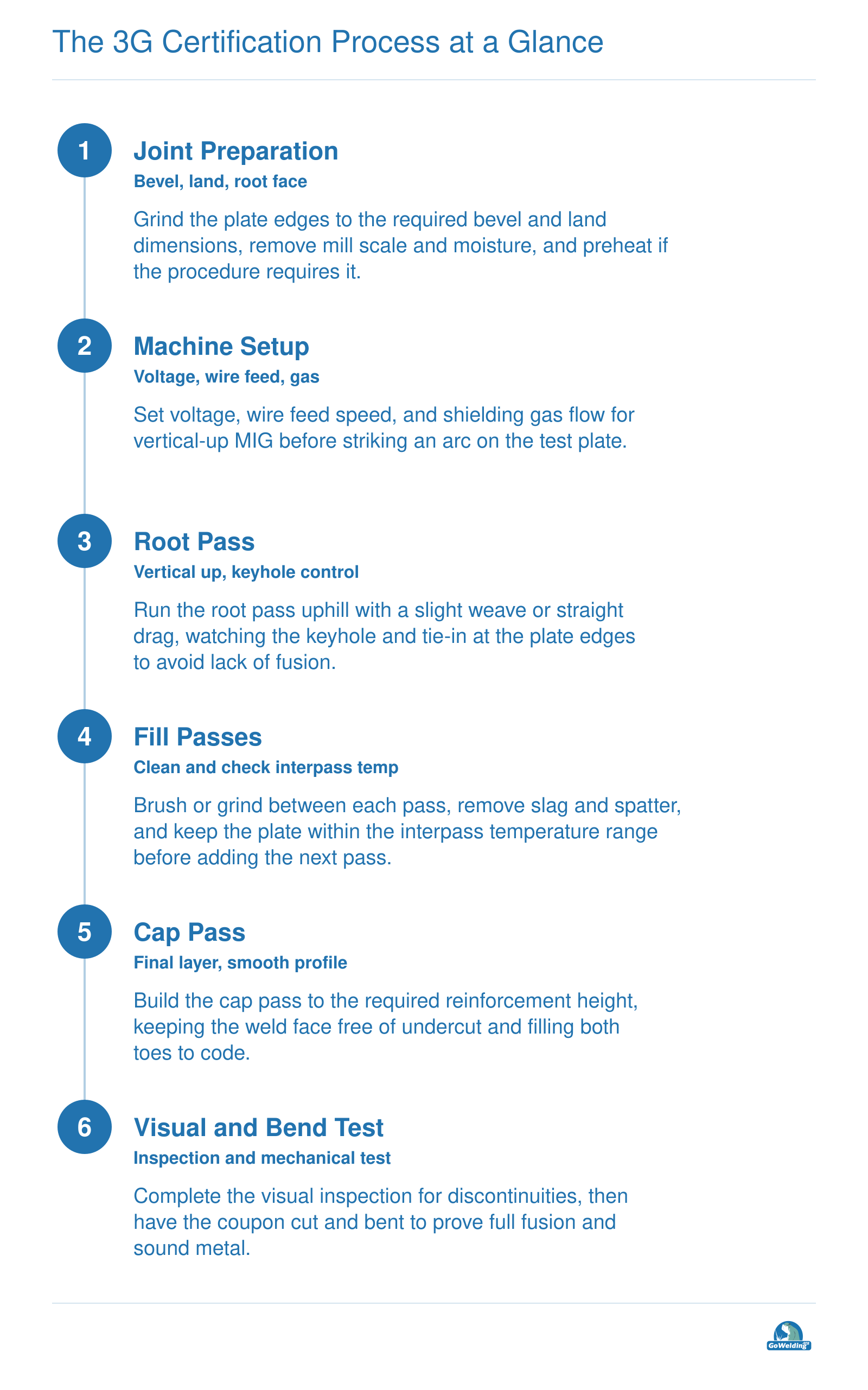

AWS D1.1 3G MIG Welding Certification Procedure Specification
The AWS D1.1 3G GMAW Welding Certification is a welding procedure that qualifies a welder to weld in the flat, horizontal, and vertical up and down positions. By passing this welding certification the welder demonstrates their ability to produce a sound weld according to the specifications of the welding procedure below. All this means is that the greedy American Welding Society has tested this procedure and has approved it to be a proven method to produce a good quality weld! If you can follow their rules and pass this test then that makes you a certified welder!
This welding procedure comes in two metal thicknesses; 3/8 inch-thick and 1 inch-thick plates. The 3/8 inch-thick procedure is a limited thickness procedure that qualifies the welder to weld from 1/8 inch-thick material up to 3/4 inch-thick material. This is the test I have just taken and am documenting how I passed it to help anyone who is about to take this test to also pass.
Once you are certified in this welding procedure you must not stop welding for more than 6 months. If you do, you will end up like me! I stopped welding for 12 years and had this certification done on the 1 inch unlimited thickness procedure, but when the 6-month mark hit my former welding certifications expired making the time and money I spent getting certified useless. Here are the technical specifications of the welding procedure

The Root Pass
To begin with, preheating of the plates did not apply to this test for me. I took this test on December 6, 2008 in South Florida. The weather at the time of the test was about 80 degrees. So I easily met the minimum preheat of 60 degrees.
To start the root pass I set the welder to the settings that I used to practice on and the welding inspector checked the amperage again. The welding machine was running at 21.6 volts at 155 amps, with the wire speed was set at 340, the INDU was set at 6, and gas flow at 25 CFH.
Since the welding procedure states the welder must stop and restart somewhere on the weld joint, I decided to stop in the middle of the root. At this point, the welding inspector checked the weld.

Filler Pass #1
MIG 3G Weld Test Filler Pass #1
This is the first fill pass I did.
Before putting in the first filler pass I waited for the plate to cool. I use a very unscientific method that works well for me. I put my hand near the plate and when the plate becomes cool enough for me to touch it then I begin the next pass.
I gound down the first filler pass/hot pass to get rid of the convexity that is so typical of a vertical up MIG weld.
On the first filler pass I used the same welding machine settings as the root pass. What I did differently is that I paused a little bit longer when I washed the weld into the sides, since the joint is wider. It's almost the same tight weave as on the root pass. I welded this pass without any restarts. Again, as you can see, the weld is very convex. Before putting in the second filler pass I ground down the center of the weld to make it flat.

The AWS D1.1 procedure clearly states that the cap must not be higher than 1/8 of an inch over the plate surface. In the American Welding Society"The face of the weld shall be flush with the surface of the base metal, and the weld shall merge smoothly with the base metal. Undercut shall not exceed 1/32 in. (1 mm). Weld reinforcement shall not exceed 1/8 in. (3 mm)"
3G MIG Welding Certification Test Cap Weld
When doing the cap you have to wait for the test plate to cool down to the point where you can touch it without burning yourself. The cap pass is going to produce a lot of heat because you will be using a wide weld.
