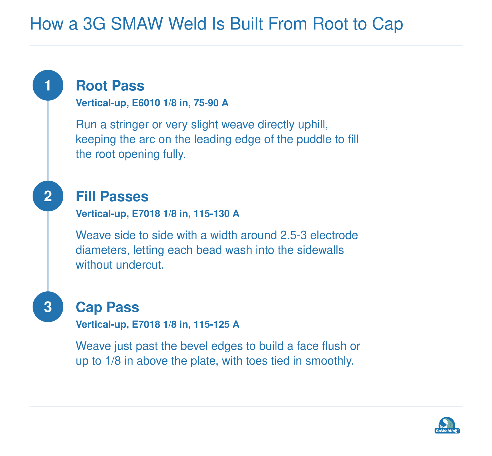

Techniques for Passing the AWS D1.1 SMAW 3G Welding Certification Root Pass
How to Do a Vertical Up Root Pass in the 3G Position with a Backing Bar

3G Test Fill Pass Welding Technique
For the hot pass or fill pass I used the same technique as the root weld. That is holding the sides and rolling the arc until the weld rides up onto the side of the bevel. I used four electrodes and had three restarts.

Weave Techniques for Vertical Up Cap Cover Pass Weld
The cap was done using a weave technique holding the corner of the bevel until it was filled and the moving onto the other side. If you do not wash weld properly into the corner of the bevel you run the chance of not penetrating the test coupon properly. On the cap of the weld I used four electrodes. Here are the picture of the cap weld.
