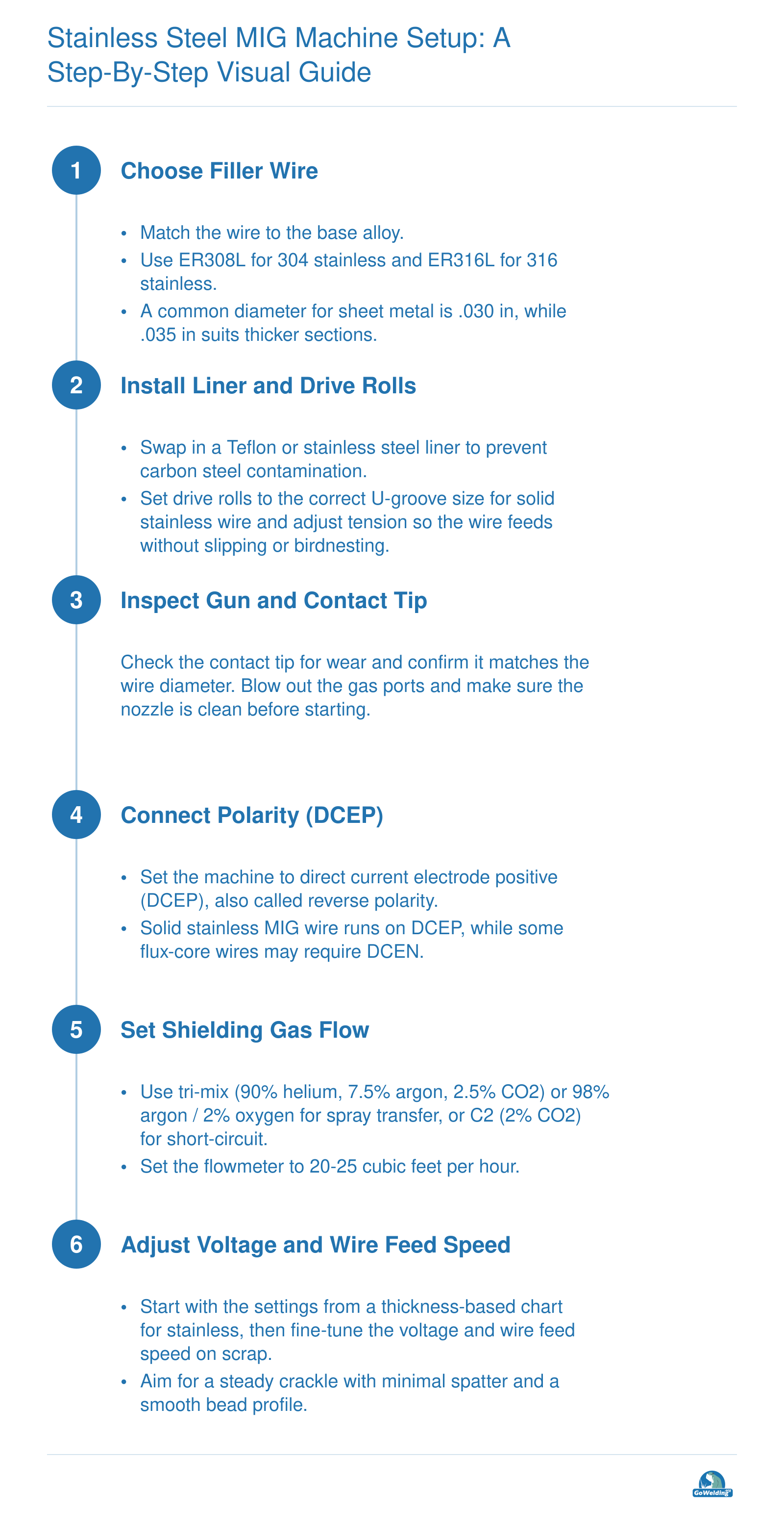

Stainless Steel MIG Machine Setup: A Step-By-Step Visual Guide
A clean MIG setup is the difference between a passable stainless weld and one that fights you with porosity, black soot, or burn-through. Follow this six-step sequence every time you switch from carbon steel to stainless.
MIG setup sequence for stainless: wire, liner, drive rolls, gun check, DCEP polarity, gas flow, voltage and wire feed speed.
Consumable Contamination Controls: Liners, Drive Rolls, and Contact Tips
Five components of MIG welding equipment carry carbon steel residue into a stainless weld: the liner, contact tip, diffuser, nozzle, and drive rolls. Run mild steel wire for MIG welding carbon steel through a gun on Monday and stainless through the same gun on Tuesday, and the iron dust embedded in that wire path transfers onto your stainless surface. Those particles rust within days of exposure to moisture, leaving orange freckles on a weld that is otherwise metallurgically sound. The fix is mechanical separation, not better MIG welding techniques.
Dedicate the Gun and Wire Path
The cleanest arrangement is a stainless-only gun, liner, and feeder.1 This is a shop-practice recommendation rather than a code requirement, but it eliminates the single most common source of iron contamination. Where budget forces one gun to serve both, clean or replace the liner, contact tip, diffuser, nozzle, and drive rolls before every switch to stainless.1 Extend the same discipline to hand tools: keep separate stainless wire brushes, grinding media, and clamping surfaces, since a carbon steel brush will smear iron across a finished bead just as effectively as a dirty liner.
For solid stainless wire, use a correctly sized steel spiral liner unless the wire manufacturer specifically approves a polymer alternative.2 PTFE and polyamide liners are aimed at aluminum and other soft wires; they wear quickly against steel and stainless, shedding debris into the wire path.2 Match liner diameter to wire diameter and gun model rather than reusing whatever came in the box.
Drive Rolls and Feed Pressure
Solid stainless wire feeds through V-groove rolls sized to the wire diameter.3 U-groove rolls belong to aluminum and bronze.3 Knurled rolls belong to flux-cored wire, and their teeth will shave solid stainless, pushing shavings straight into the liner and tip.4 If you are running a stainless flux-cored wire, follow the wire maker's roll recommendation instead of the solid-wire rule.
Set drive roll tension at the minimum that feeds without slipping.5 Excess pressure ovalizes the wire, which makes it harder to push through the liner, accelerates liner and tip wear, and increases arcing inside the tip.
Contact Tip Selection
Use a tip rated for stainless with a bore matching your exact wire diameter and the correct gun thread.4 Lincoln's 350A tapered tips, for example, cover steel, stainless, and silicon bronze in sizes including 0.045 inch (1.2 mm) for the POWER MIG 262.6 An oversized bore lets the wire wander and destabilizes the arc; undersized invites burnback. Replace any tip that is worn, obstructed, contaminated, or feeding erratically.5
