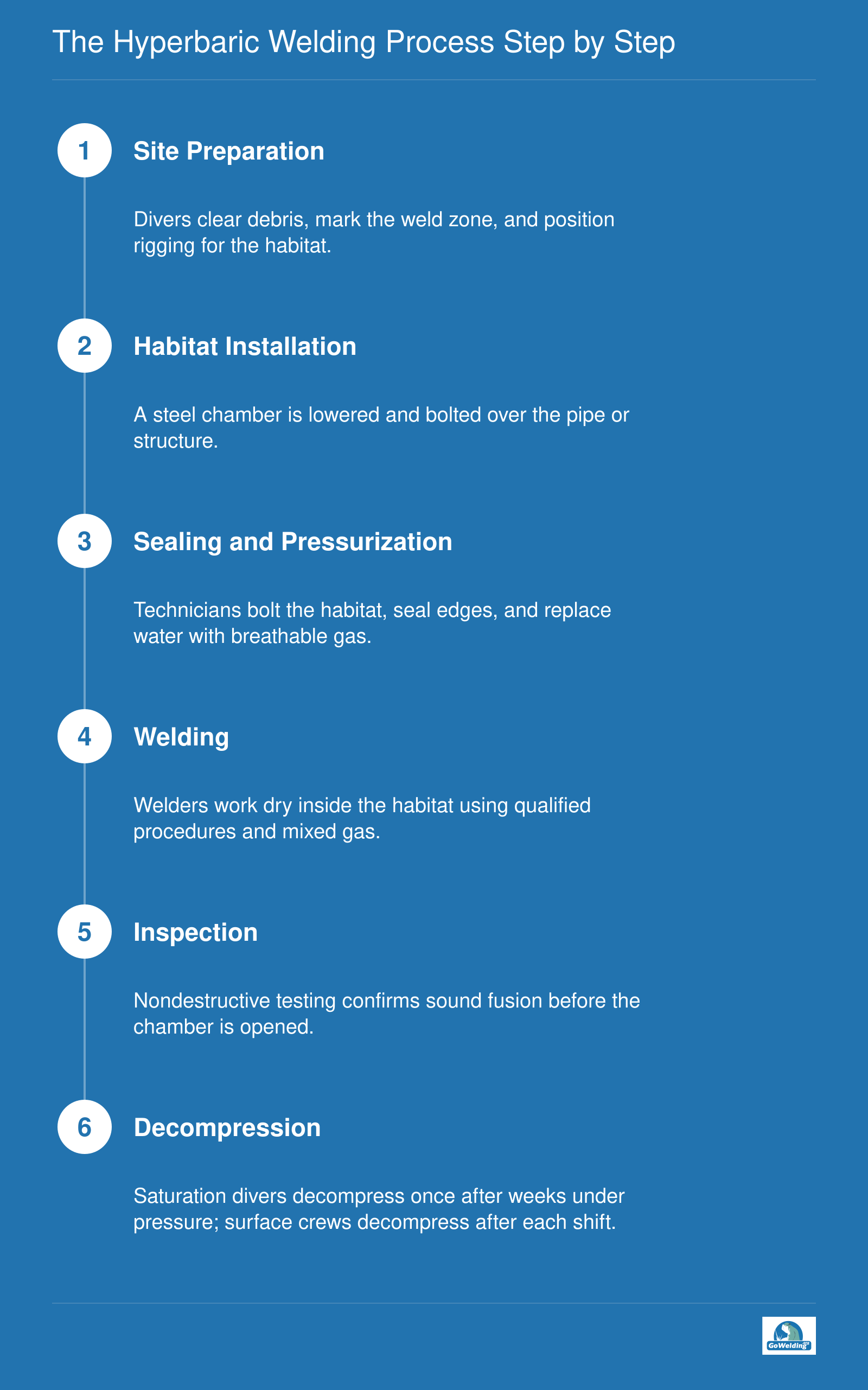

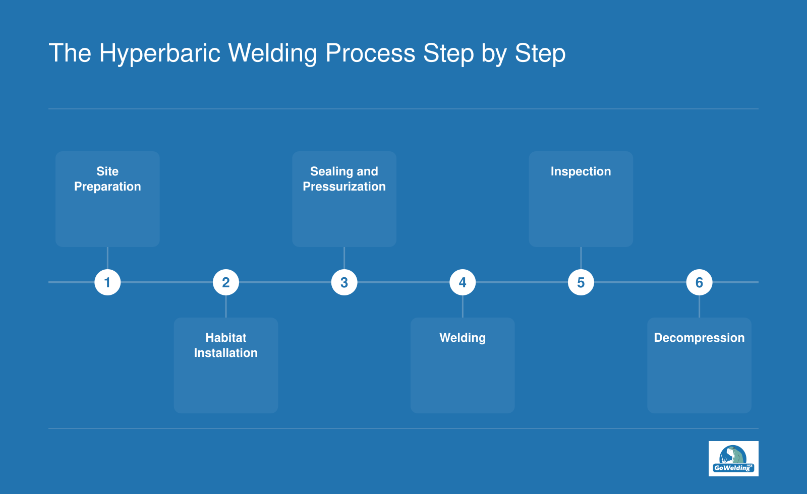

The Hyperbaric Welding Process Step by Step
Dry hyperbaric welding follows a controlled sequence that keeps water out and pressure managed. Saturation diving is used for deep, multi-day work, while surface decompression suits shorter jobs. The order below reduces wet-weld defects and protects the divers.
