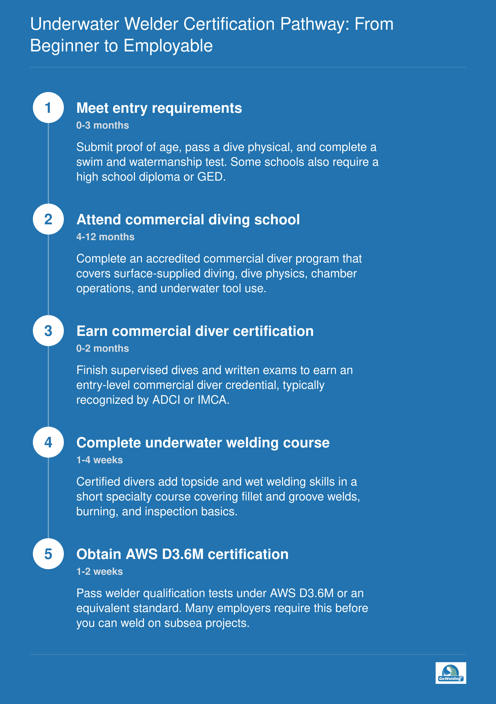

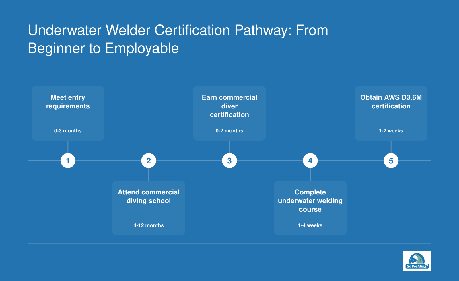

Underwater Welder Certification Pathway: From Beginner to Employable
Underwater welding requires commercial diver certification first, so the path looks different from a typical welding program. These five steps show the typical route from beginner to employable underwater welder, with approximate time for each stage. The first three steps are mandatory before any welding-specific training begins.

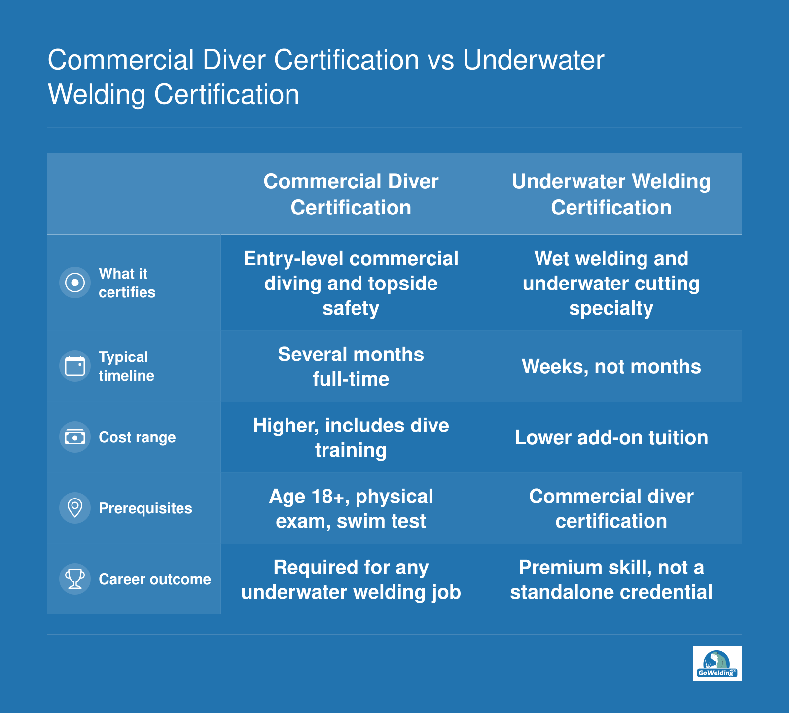

Commercial Diver Certification vs Underwater Welding Certification
Underwater welding requires two separate credentials. Commercial diver certification is the entry requirement for all underwater work, and underwater welding certification is a shorter add-on that qualifies a diver for wet welding and cutting.
