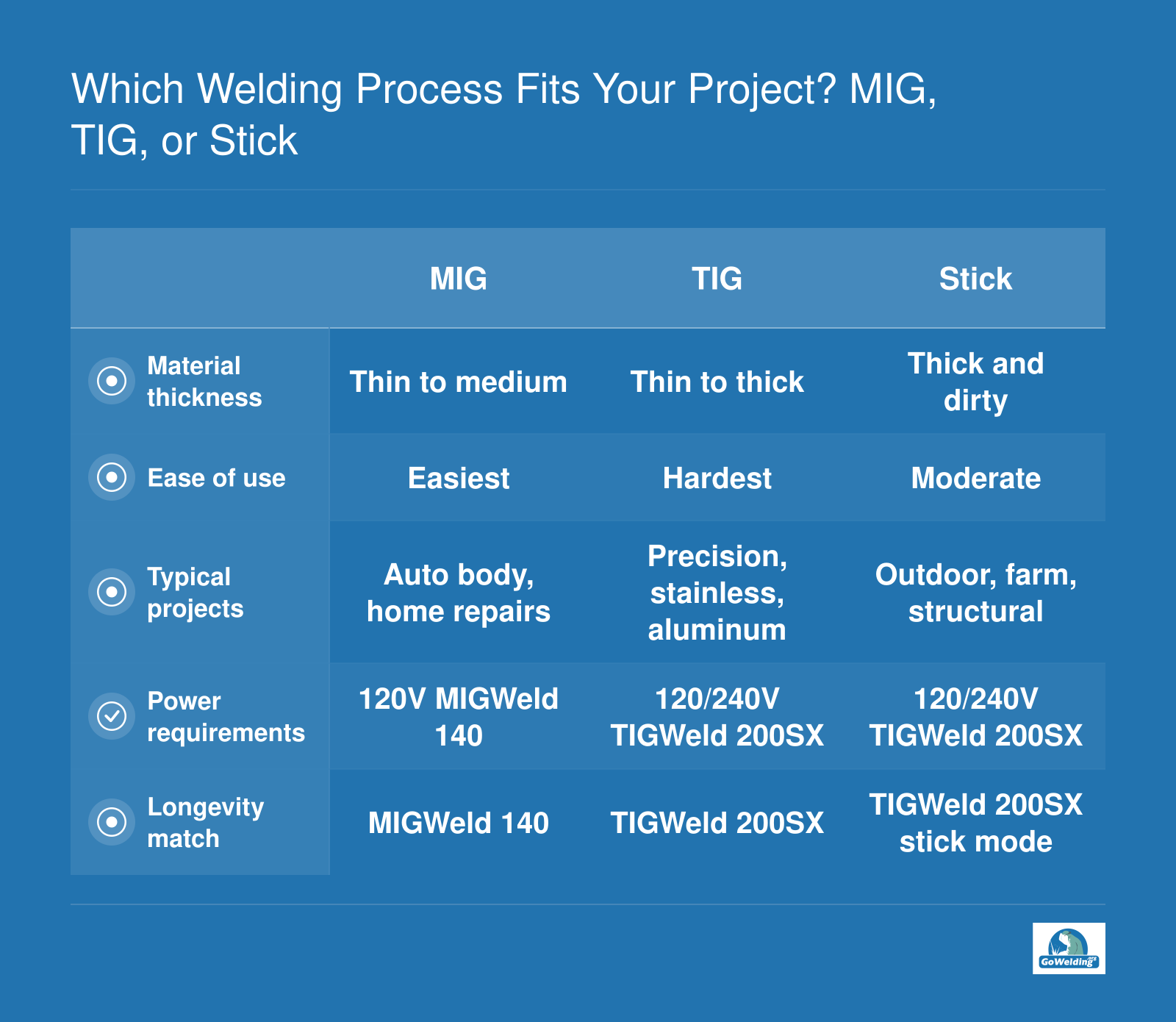

Which Welding Process Fits Your Project? MIG, TIG, or Stick
Welding processes are not interchangeable. MIG is the fastest way to get started, TIG delivers precision on thin and nonferrous metals, and stick handles dirty or outdoor work where cleanup is limited. The Longevity MIGWeld 140 covers entry-level MIG and flux-core, while the TIGWeld 200SX covers TIG and stick from the same machine.
