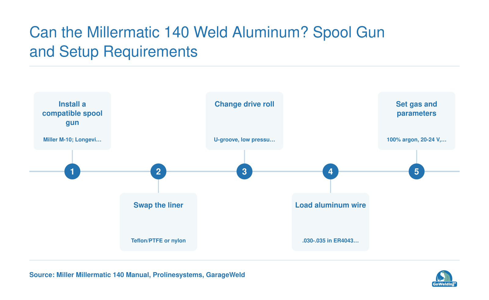

Can the Millermatic 140 Weld Aluminum? Spool Gun and Setup Requirements
A 140-amp MIG machine can weld aluminum, but only for light duty work after you convert the wire feed path and switch to argon. These setup steps make thin aluminum sheet practical; thicker aluminum quickly exceeds what a 140-class machine can sustain.
Five step setup sequence for welding thin aluminum sheet with a 140 amp MIG welder using a spool gun and argon.
