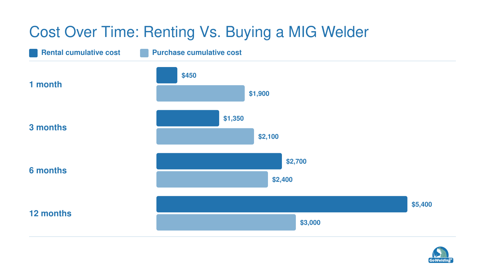

Cost Over Time: Renting vs. Buying a MIG Welder
Using a common mid-range MIG welder as an example, this chart stacks up cumulative rental payments against the purchase price plus ongoing maintenance. Rental costs climb steadily, while the bought machine flattens after the initial outlay. The lines cross around the five-month mark, which is when owning starts to save money.
Cumulative rental vs purchase cost for a MIG welder at 1, 3, 6, 12 months, crossover near five months.
Welding machines depreciate far more slowly than most shop tools. A 2026 brand resale comparison found used Miller units typically resell for 60 to 75 percent of original retail, Lincoln consumer models 50 to 65 percent, and Hobart 40 to 55 percent. Buy well, and your exit cost is smaller than you think.
