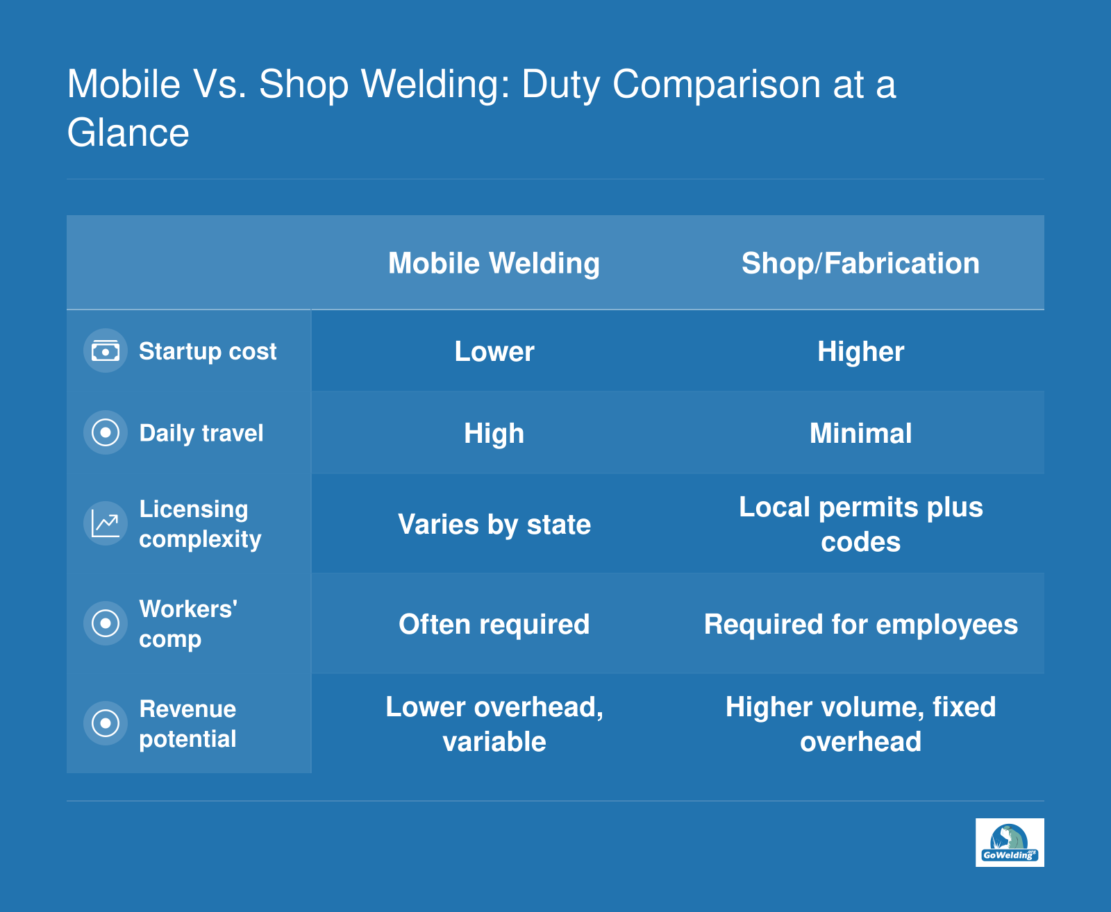

Mobile vs. Shop Welding: Duty Comparison at a Glance
Mobile welding and shop fabrication shift the owner's daily duty load in different ways. This side-by-side compares five factors that shape your cost, time, and compliance obligations.
Comparison of five duty factors for mobile welding versus shop fabrication: startup cost, travel, licensing, workers' comp, and revenue potential.
