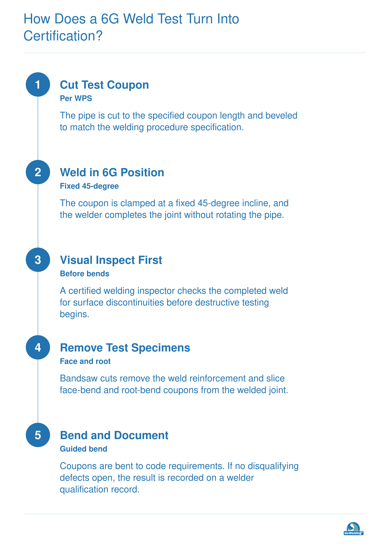

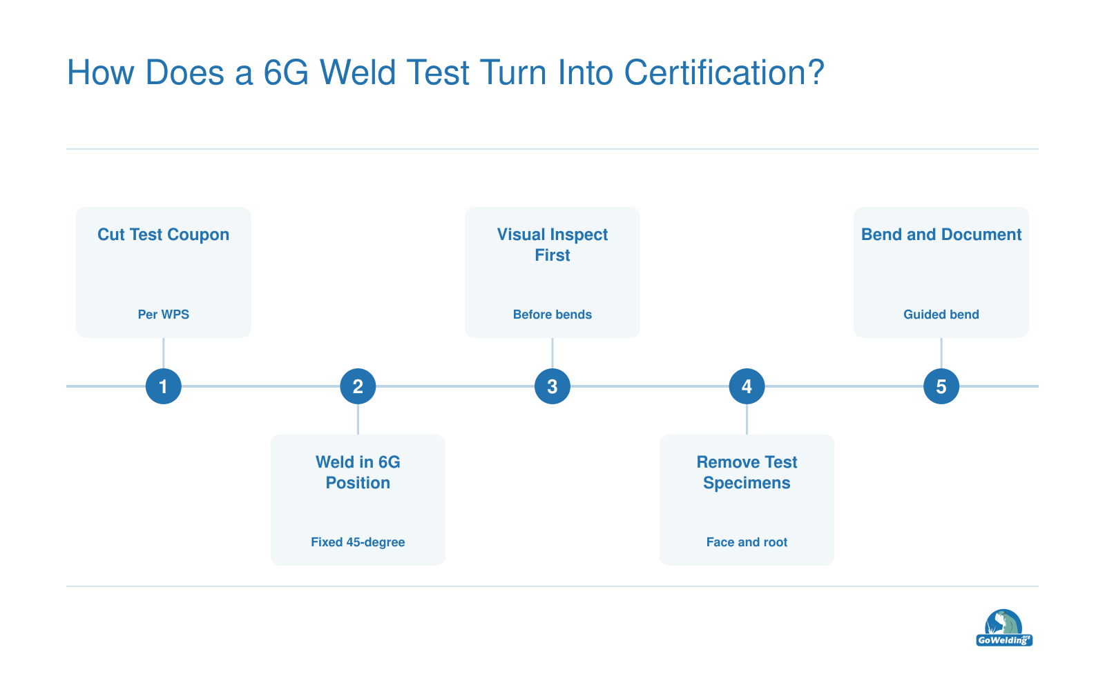

How Does a 6G Weld Test Turn Into Certification?
The 6G pipe test turns a single welded coupon into proof of open-root pipe skill. Each step builds toward a documented qualification record, and the destructive bend test is the final check before certification.
