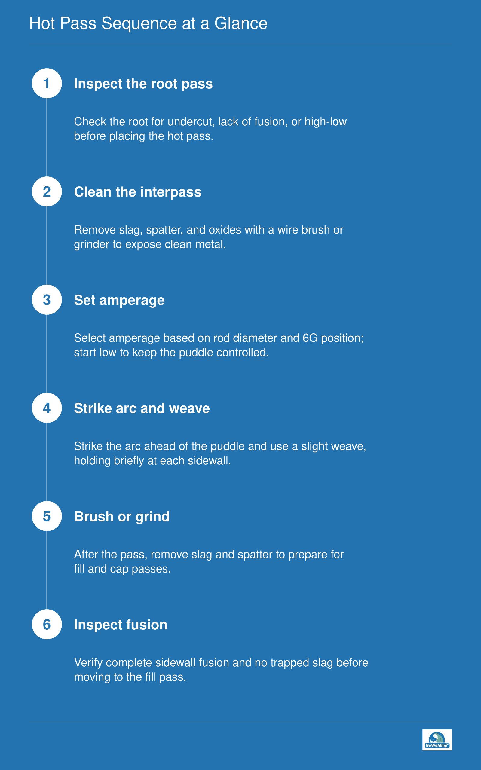

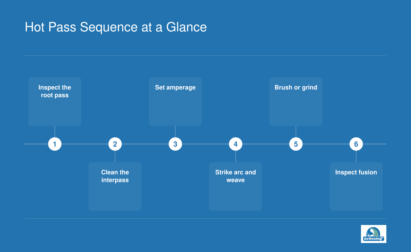

Hot Pass Sequence at a Glance
The hot pass locks in the root and starts building the joint. Follow this sequence after the root pass passes inspection and before any fill or cap pass.
Ordered six-step process for a 6G pipe hot pass with E7018, from root inspection to final fusion check.
