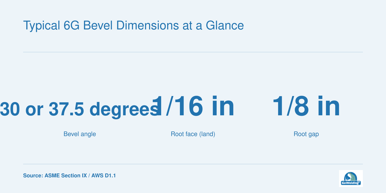

Typical 6G Bevel Dimensions at a Glance
A 6G open-root pipe test coupon uses a specific bevel profile. The three numbers that matter most at the grinding bench are the bevel angle, the root face (also called the land), and the root gap. Keep these in the range shown, then inspect the bevel all the way around before tacking.
Typical 6G open-root pipe bevel dimensions: 30 or 37.5 degree bevel angle, 1/16 inch root face, 1/8 inch root gap.
