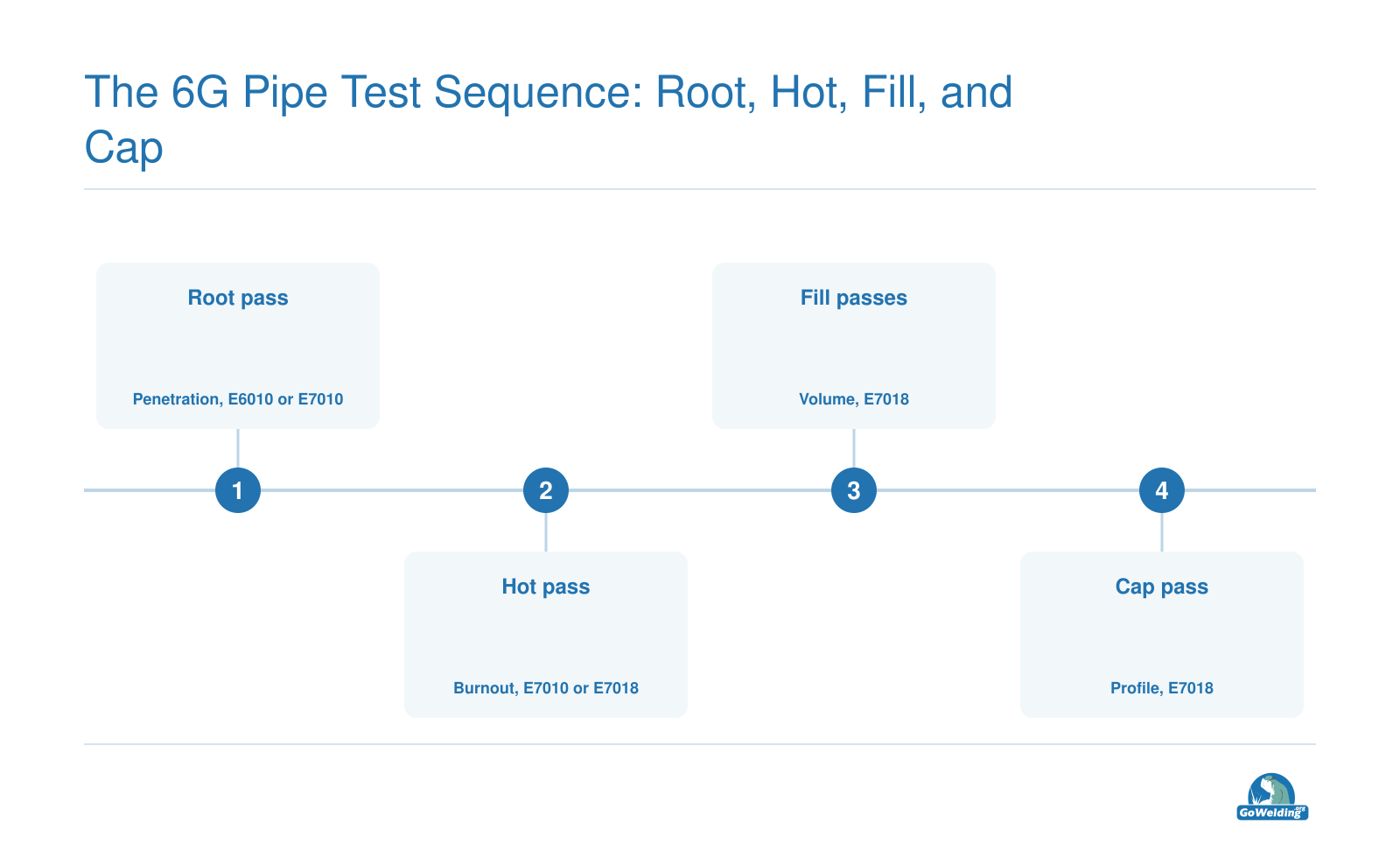

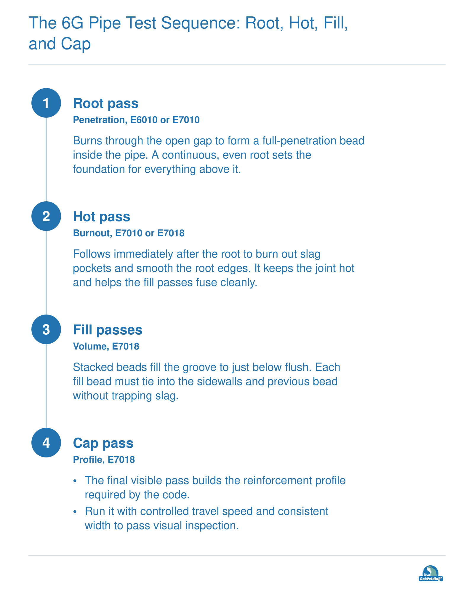

The 6G Pipe Test Sequence: Root, Hot, Fill, and Cap
The 6G pipe groove weld is built in four controlled passes. Each pass cleans and prepares the joint for the next, and the cap pass should not be rushed.

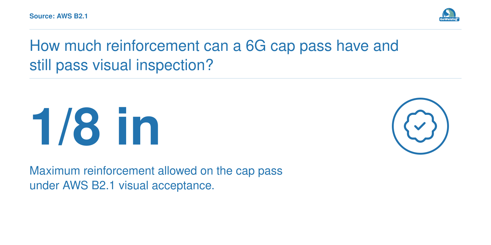

How Much Reinforcement Can a 6G Cap Pass Have and Still Pass Visual Inspection?
AWS B2.1 sets strict visual limits for the completed cap pass on a 6G pipe test. Reinforcement, or weld height above the pipe surface, is one of the first things an inspector checks. Exceeding the maximum reinforcement fails the test before destructive testing begins.
