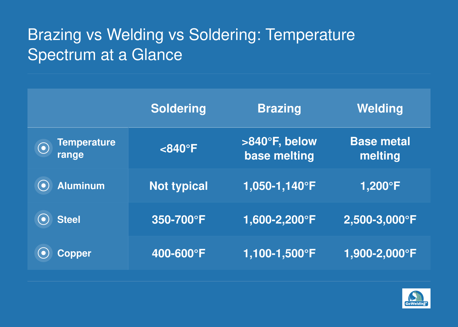

Brazing vs Welding vs Soldering: Temperature Spectrum at a Glance
The three processes are separated by one simple question: does the base metal melt? Soldering stays below 840°F, brazing crosses that threshold while keeping the base metal solid, and welding melts the base metal itself. The table below shows roughly where each process lands for aluminum, steel, and copper.
Temperature ranges: soldering below 840°F, brazing above it below the base metal melting point, welding melts the base metal

The number that separates brazing from soldering is 840 degrees Fahrenheit, or 450 degrees Celsius. Below that line, you're soldering. At or above it, you're brazing. Both processes join metal by melting a filler that flows into a fitted joint, but the base metal itself never reaches its melting point in either case. That single fact, the base metal staying solid, is what separates brazing and soldering from welding altogether.

MIG welding, like all welding, pushes both pieces of base metal past their melting point, often north of 2,000°F for steel, and fuses them directly. Brazing tops out in the 1,100 to 1,600°F range for most common filler metals, and that base metal stays fully solid throughout. Less total heat goes into the part. That translates into real energy savings on production runs and, more importantly, protects the microstructure of heat-sensitive alloys. Hardened tool steels, certain stainless grades, and thin-wall tubing can lose temper or develop brittle zones under welding heat, including TIG welding. Brazing sidesteps that risk entirely.
