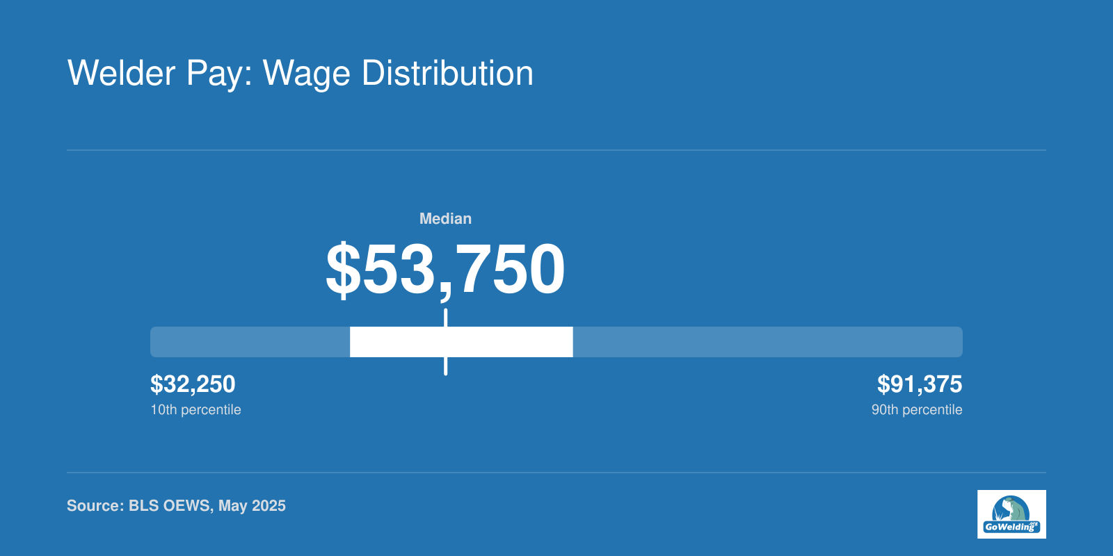

Welder pay is far from uniform across the country. According to the Bureau of Labor Statistics (May 2025), the highest-paying metro areas pay welders, cutters, solderers, and brazers well above the national median, with specialized pipeline, refinery, and shipyard work driving much of that gap. A certification that matches local industry often matters more than the city itself.
Did you know welder pay varies more than most trades? According to BLS data for May 2025, the top 25 percent of welders earned $63,850 or more annually, while the bottom 25 percent earned $38,220 or less, a spread of over $25,000 driven largely by certification level, position testing, and pipe versus plate specialty.
Welder Pay: Wage Distribution
National welder pay shows a clear middle: half of all welders earn between about $46,800 and $63,000 a year, with the median at $53,750. The range is wide enough to matter by industry, location, and certifications.
