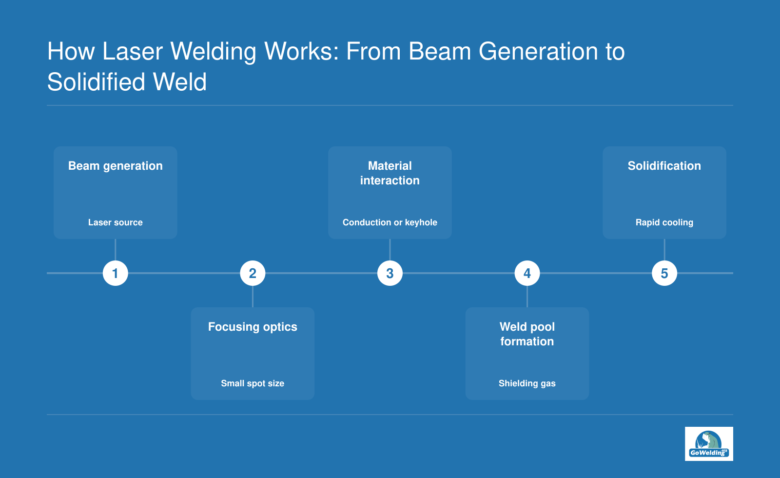

How Laser Welding Works: From Beam Generation to Solidified Weld
A laser weld starts with a concentrated beam of light and ends with a narrow, fused seam. The sequence below shows the five stages that repeat at every joint, whether the beam is delivered through a fiber optic cable or an articulated arm.

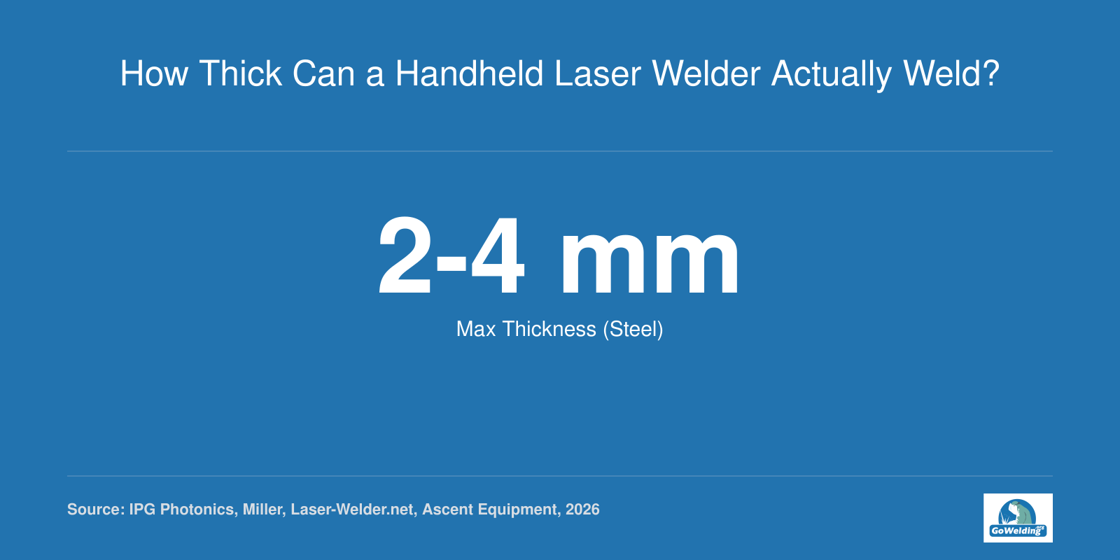

| Carbon steel | 2.0 to 4.0 | N/A | 30 to 80 | 0 to +2 mm above surface | Nitrogen, ≥20 L/min |
| General material groups | N/A | N/A | 30 to 80 | 0 to +2 mm above surface | 15 to 30 L/min |
| General laser welding | 5.0 to 6.0 | N/A | N/A | 0 mm | 10 to 12 L/min |

How Thick Can a Handheld Laser Welder Actually Weld?
