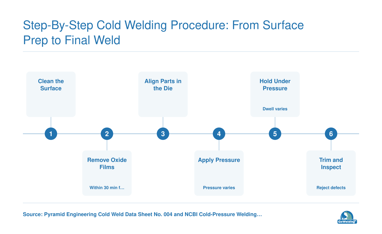

Step-by-Step Cold Welding Procedure: From Surface Prep to Final Weld
Cold welding follows a controlled sequence from highly clean metal surfaces to a finished solid-state joint. The exact settings vary with alloy, part geometry, and tooling, so these steps reflect typical practice rather than a universal recipe.
Copper and aluminum, two dissimilar metals with very different lattice structures, can still cold weld at room temperature under enough pressure. A study published in MDPI Metals recorded joint strengths around 74 MPa in copper to aluminum cold pressure welds, achieved using pressures near 2000 MPa, no heat required. Aluminum alone typically needs about 40 percent deformation to bond this way.
