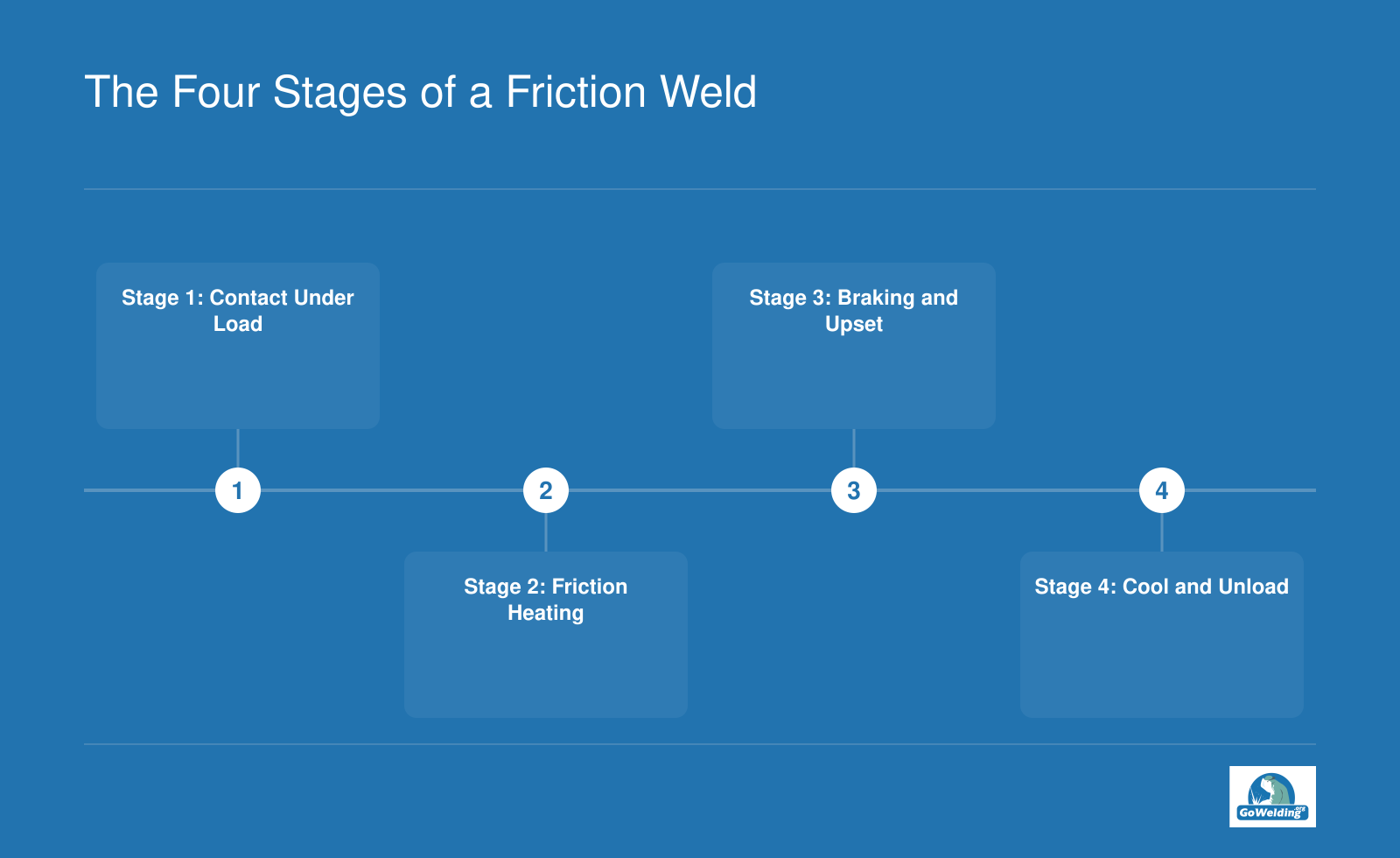

How Does Friction Welding Work? The Step-by-Step Mechanism
Among the major Welding Processes, friction welding joins two pieces by rubbing them together under pressure until the contact surfaces get hot enough to fuse, then squeezing them solid as they cool. Unlike MIG welding, it uses no filler rod, no arc, and no shielding gas. Think of rubbing your palms together on a cold day: friction builds heat fast, and if you pressed your hands together hard enough at that point, they'd bond. That's the whole idea, scaled up to steel and titanium.
The Four Stages in Sequence
- Friction (heating) stage: One part rotates or oscillates against the other under an initial axial force. Surface asperities shear and generate intense localized heat.
- Plasticization: The interface reaches a hot, plastic (not molten) state. A visible flash of softened material begins to squeeze outward.
- Upsetting stage: Relative motion stops abruptly and axial force spikes. This forge force drives the plasticized material together, extruding oxides, contaminants, and excess flash out of the joint.
- Forging and cooling: Pressure holds while the joint cools under load, allowing the material to recrystallize into a solid-state bond with no melting involved.
What the Machine Controls
Rotational speed and friction time determine how much heat builds and how deep the plasticized zone extends. Axial pressure during the friction stage controls how fast that heat generates and how much material gets pushed into the flash. Forge force, applied once motion stops, is what actually consolidates the bond and forces impurities out of the joint line rather than leaving them trapped inside. Get any of these variables wrong and you end up with a cold, incomplete bond or excessive material loss.
Why This Matters for Consistency
Because these four variables (speed, force, time, forge pressure) can all be programmed and monitored electronically, friction welding is remarkably repeatable. Once a machine is dialed in for a given material and part geometry, it will produce the same joint quality thousands of times in a row, which is exactly why automotive and aerospace suppliers rely on it for high-volume, safety-critical components.
The Four Stages of a Friction Weld
