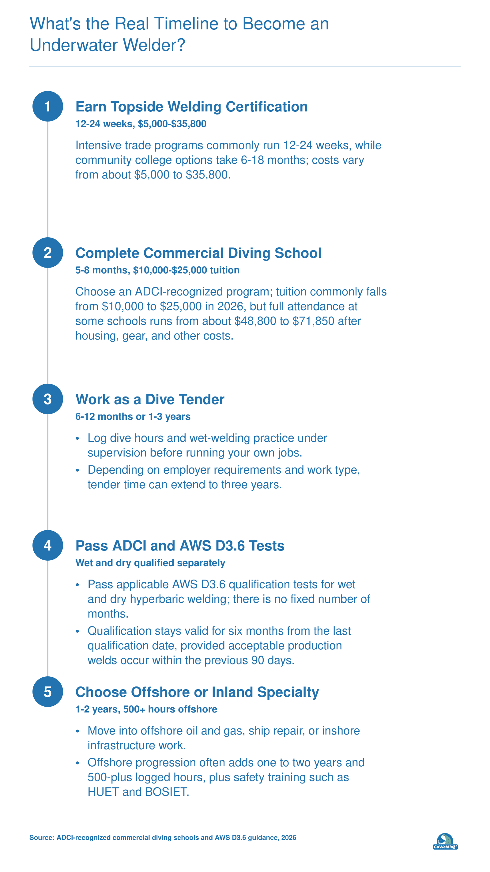

What's the Real Timeline to Become an Underwater Welder?
Plan the path as a sequence, not a single course. From topside welding through commercial dive school, tender hours, and AWS D3.6 qualification, most people need roughly 2-5 years. Training costs commonly fall between $15,000 and $45,000 before dive gear, travel, living expenses, and add-on safety certifications.
Five-step training path from topside welder certification to underwater welder, taking 2 to 5 years and $15,000 to $45,000.

  • 1. Complete topside welding certification: Get comfortable with structural welding on land. A solid AWS D1.1 qualification, or equivalent structural cert such as 6G pipe welding, shortens your underwater learning curve and makes you a stronger candidate for dive school sponsorships and entry jobs.
  • 2. Enroll in an accredited commercial diving school: A commercial diving program, not a recreational scuba course, is the non-negotiable step. Look for accredited schools that cover dive physics, chamber operations, rigging, underwater cutting, and wet welding. GoWelding.org's commercial diving schools directory helps you compare accredited options.
  • 3. Log dive tender hours: Most new commercial divers start as tenders. You run the diver's umbilical, manage tools and communications, and learn underwater job planning from the surface. Tender hours are not filler; they teach the habits that keep you alive later.
  • 4. Earn ADCI/AWS D3.6 qualification: Employers in ship repair and offshore work want the AWS D3.6 standard for underwater welding. Many also look for ADCI commercial diver certification. Use the certification guides on GoWelding.org to understand test structure and prep requirements.
  • 5. Target first job applications: Apply to inland marine contractors, shipyards, bridge and dam maintenance crews, and diving service companies. Use the welding jobs on Indeed search to find openings and the welding schools directory to identify training partners near you.
Realistic Timeline and Starting Inland
From zero experience, expect 2 to 5 years to full certification. You can complete welding school and a commercial diving program in roughly two years, but earning tender hours and passing a D3.6 weld test adds another year or two. Starting inland is the smart move. Inland jobs are less competitive than offshore rigs, pay enough to build savings, and give you the logged dives and repair experience offshore employers request later. After 18 to 24 months inland, apply offshore if that is your target.
