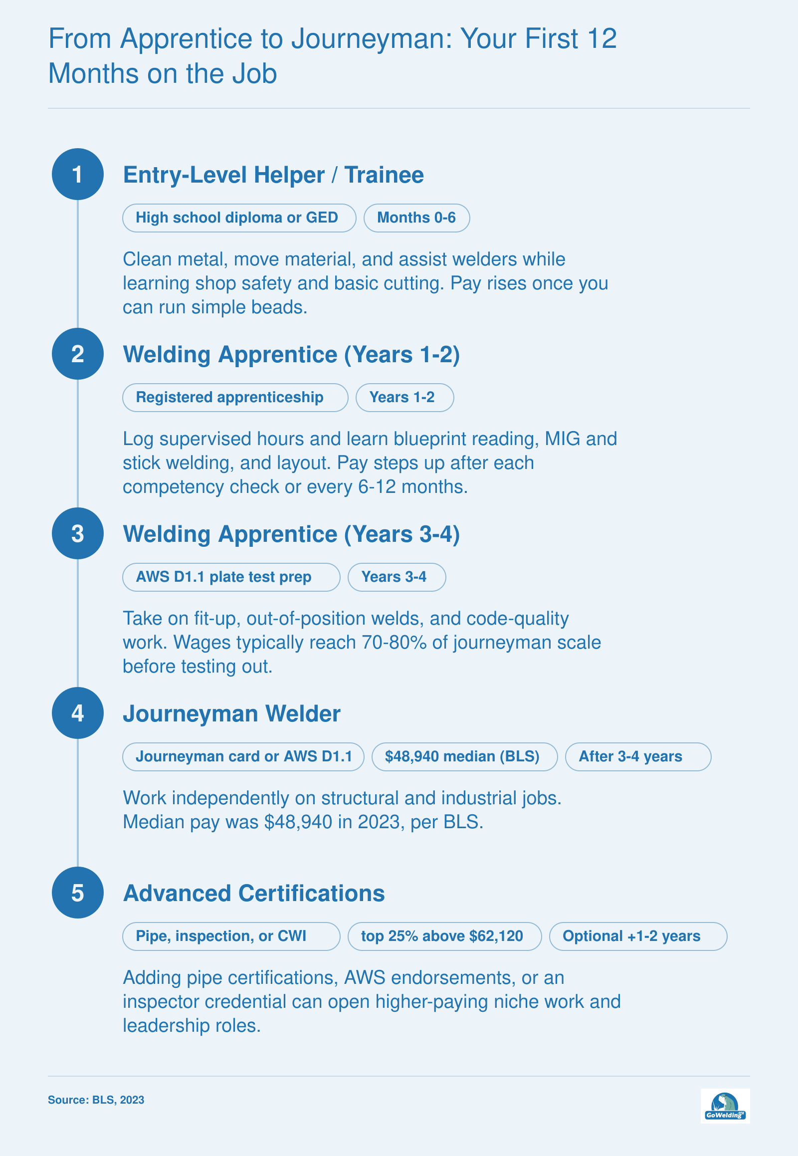

From Apprentice to Journeyman: Your First 12 Months on the Job
The first 12 months of a welding career are about supervised hours and proving clean, code-quality welds. Most start as helpers, then move into a registered apprenticeship with step-based pay.
