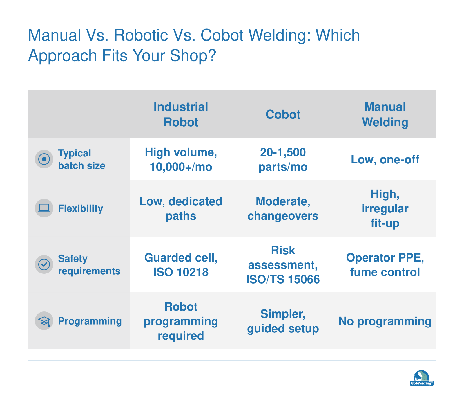

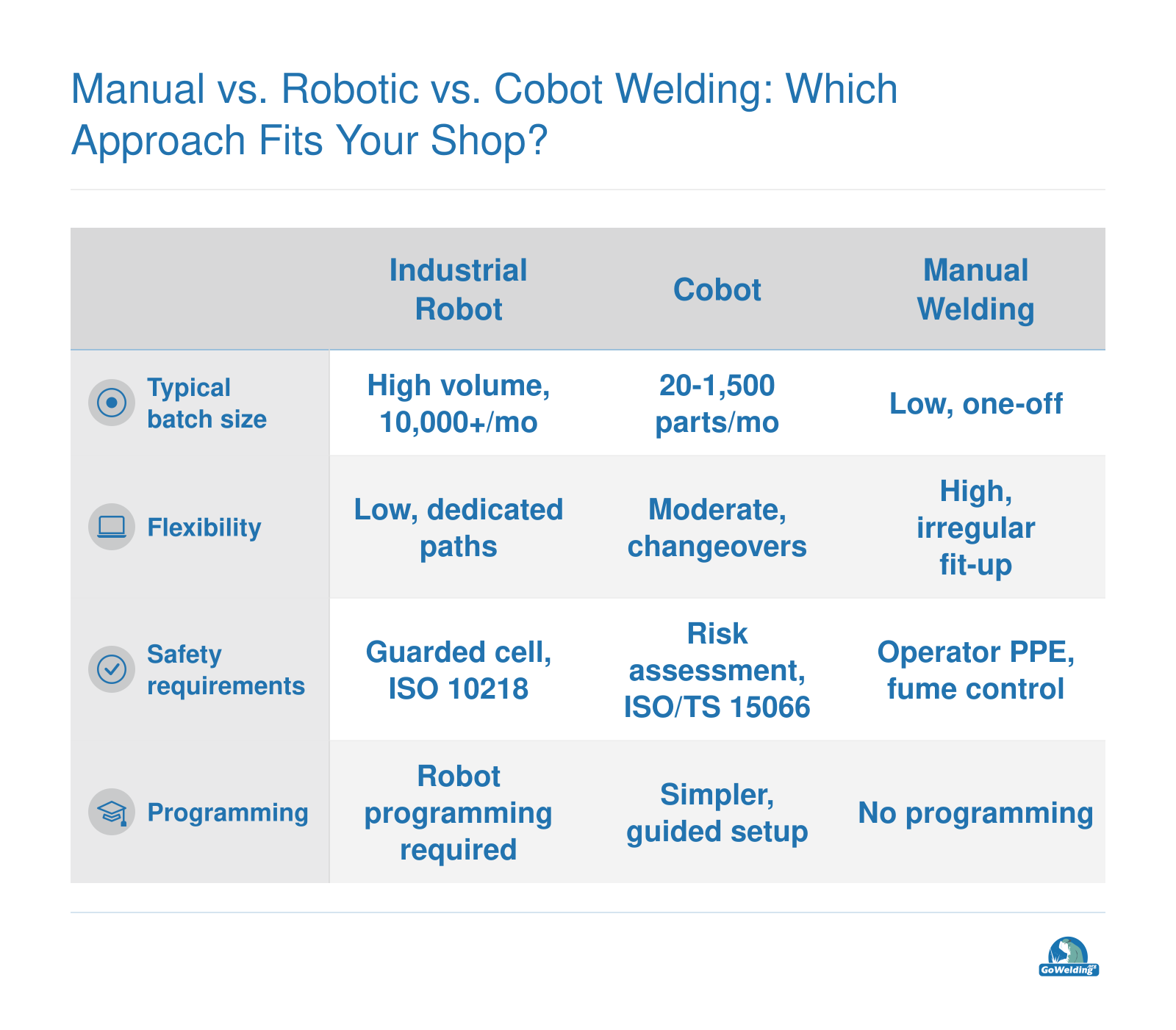

Manual vs. Robotic vs. Cobot Welding: Which Approach Fits Your Shop?
Industrial robots, welding cobots, and manual welding each fit different production realities. Use this scorecard to match the approach to your part mix, volume, and shop constraints.

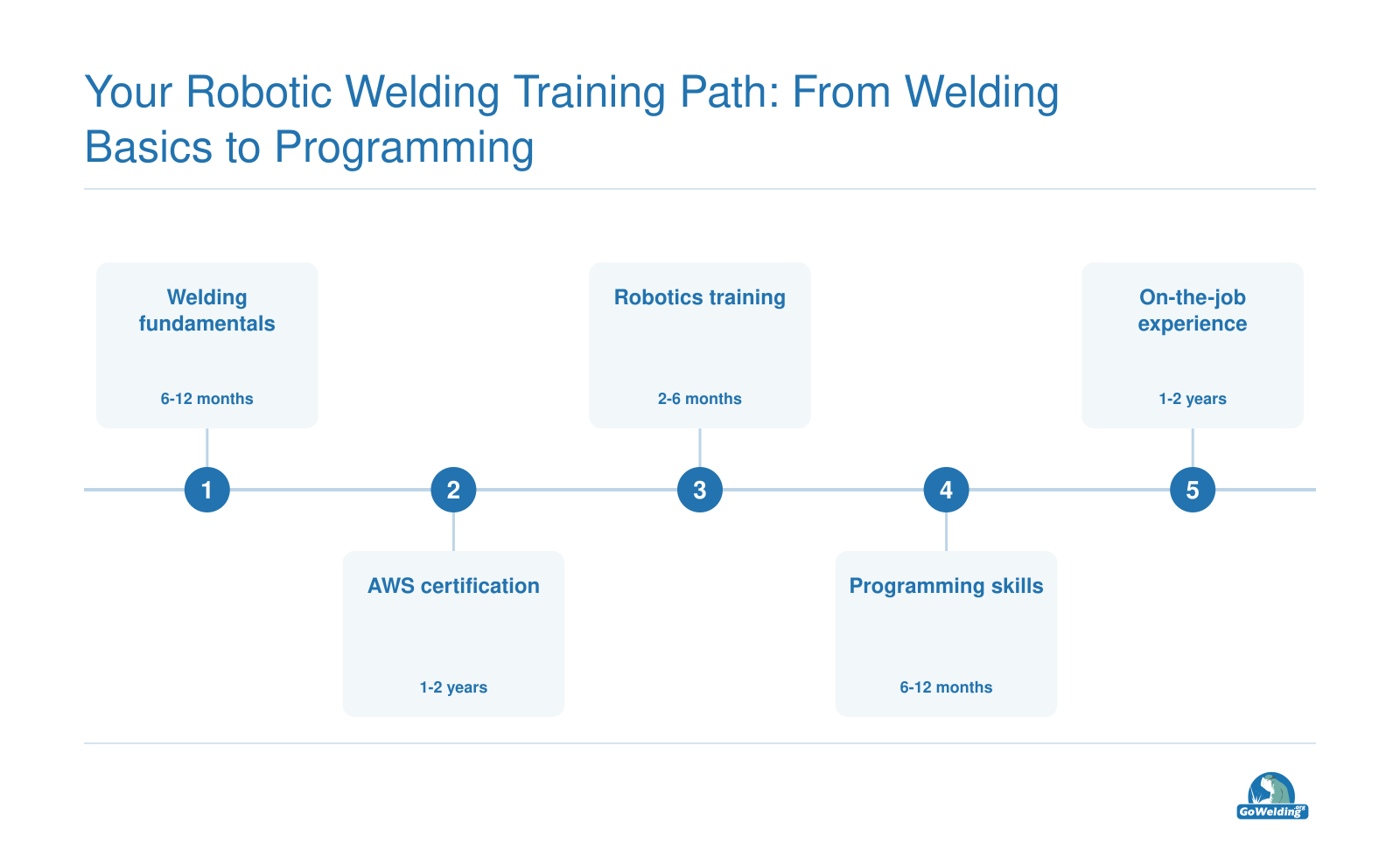

Your Robotic Welding Training Path: From Welding Basics to Programming
Most robotic welding technicians start as manual welders, then add automation skills in stages. This path assumes you are entering from scratch; experienced welders may skip or shorten the first step.
