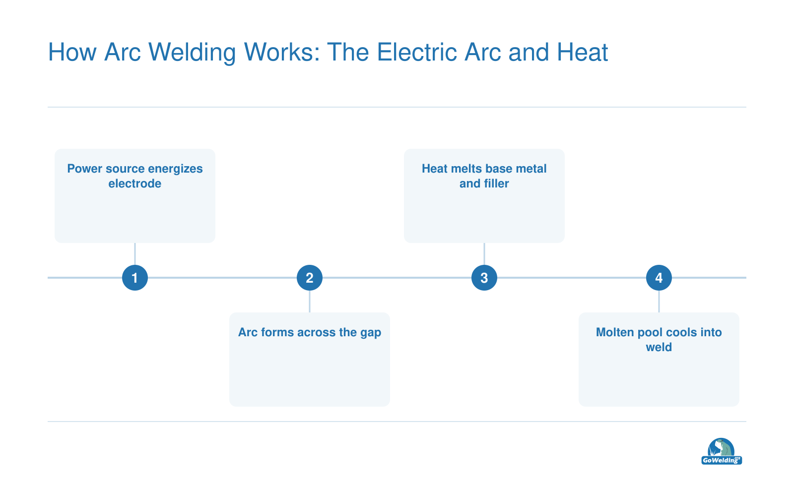

The Core Principle: Electricity Jumps a Gap
Strip away the equipment differences and the physics is consistent across every process. A welding power source drives current through an electrode held near, but not touching, the base metal. Electricity jumps that small gap, ionizing the air into a plasma channel and creating an arc that can exceed 6,500°F. That concentrated heat melts the base metal and filler simultaneously, and as the molten pool cools, the two pieces fuse into one continuous joint.
How Arc Welding Works: The Electric Arc and Heat
Arc welding uses a sustained electric arc to generate concentrated heat at the joint. A stable arc can reach roughly 6,500°F (3,600°C), and heat input rises with amperage and voltage while decreasing with travel speed. Here is the four-step sequence.
