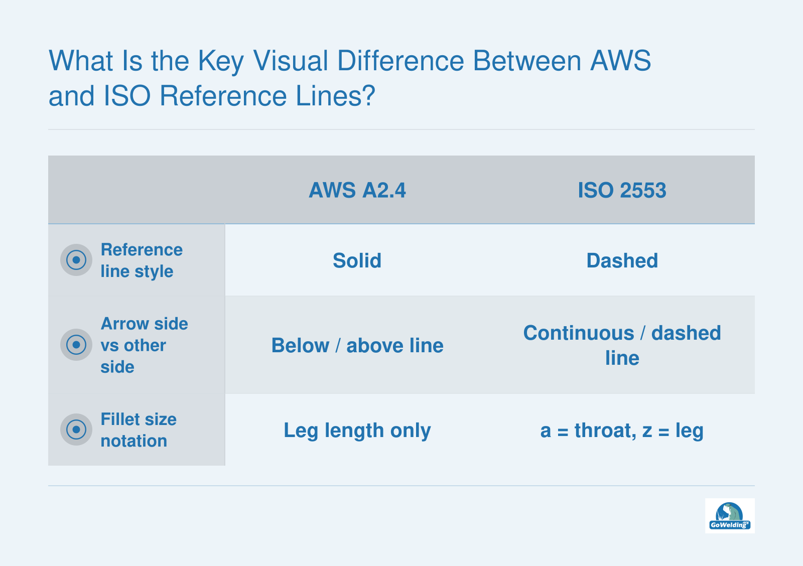

ISO 2553 System A: Solid vs. Dashed Lines
ISO 2553 System A uses a different visual cue: a solid reference line paired with a dashed identification line. The symbol on the solid line is the arrow side, and the symbol on the dashed line is the other side. The dashed line can be drawn above or below the solid line without changing meaning, which often confuses welders more familiar with AWS. For both-sides welds, the symbol appears on both the solid and dashed lines. This line-type method removes any dependence on above/below position.
Size Notation: a and z on Each Side
Only ISO 2553 System A uses the a and z dimension letters. The letter a denotes throat thickness, and z denotes leg length. In AWS, a fillet below the line with a 6 means an arrow-side fillet with a leg length of 6.1 A fillet above the line with 8 means the other-side fillet has a leg length of 8. ISO 2553 System A shows the same values, but the side comes from solid versus dashed line placement, not above or below.
- AWS arrow side: fillet below line, 6 (leg length).
- AWS other side: fillet above line, 8 (leg length).
- ISO arrow side: fillet on solid line, a 6.
- ISO other side: fillet on dashed line, z 8.
What Is the Key Visual Difference Between AWS and ISO Reference Lines?
Two reference-line styles dominate welding drawings: AWS A2.4, used widely in North America, and ISO 2553, common in Europe and internationally. The main visual difference is a solid reference line in AWS versus a dashed identification line in ISO. The table below shows how each standard marks the arrow side, the other side, and fillet weld size.

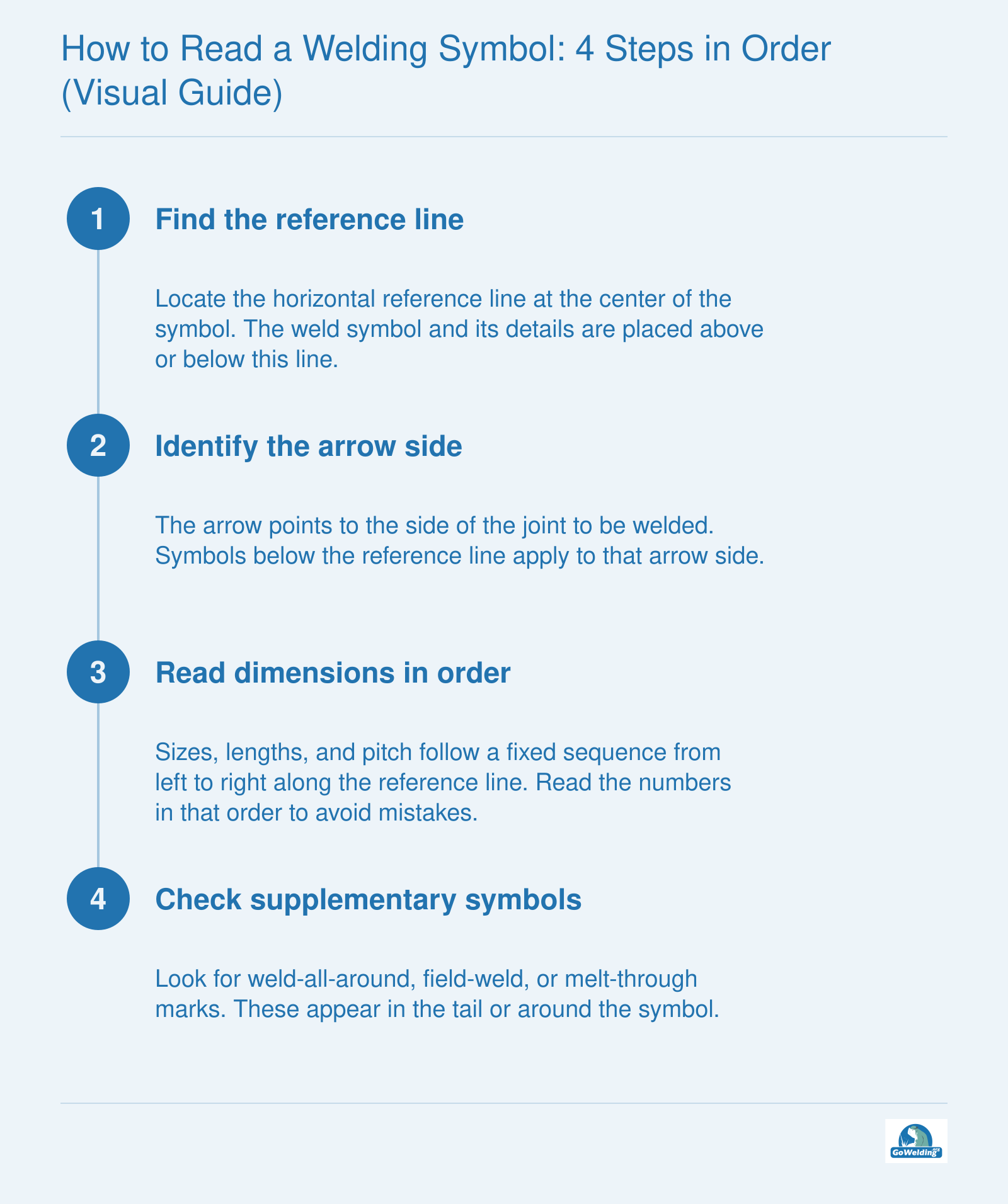

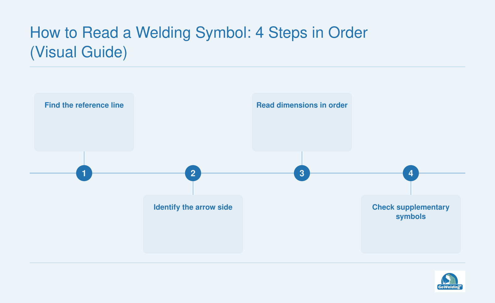

How to Read a Welding Symbol: 4 Steps in Order (Visual Guide)
When you encounter a welding symbol on a print, read it in a consistent order. This four-step sequence prevents misinterpretation and missed callouts.
