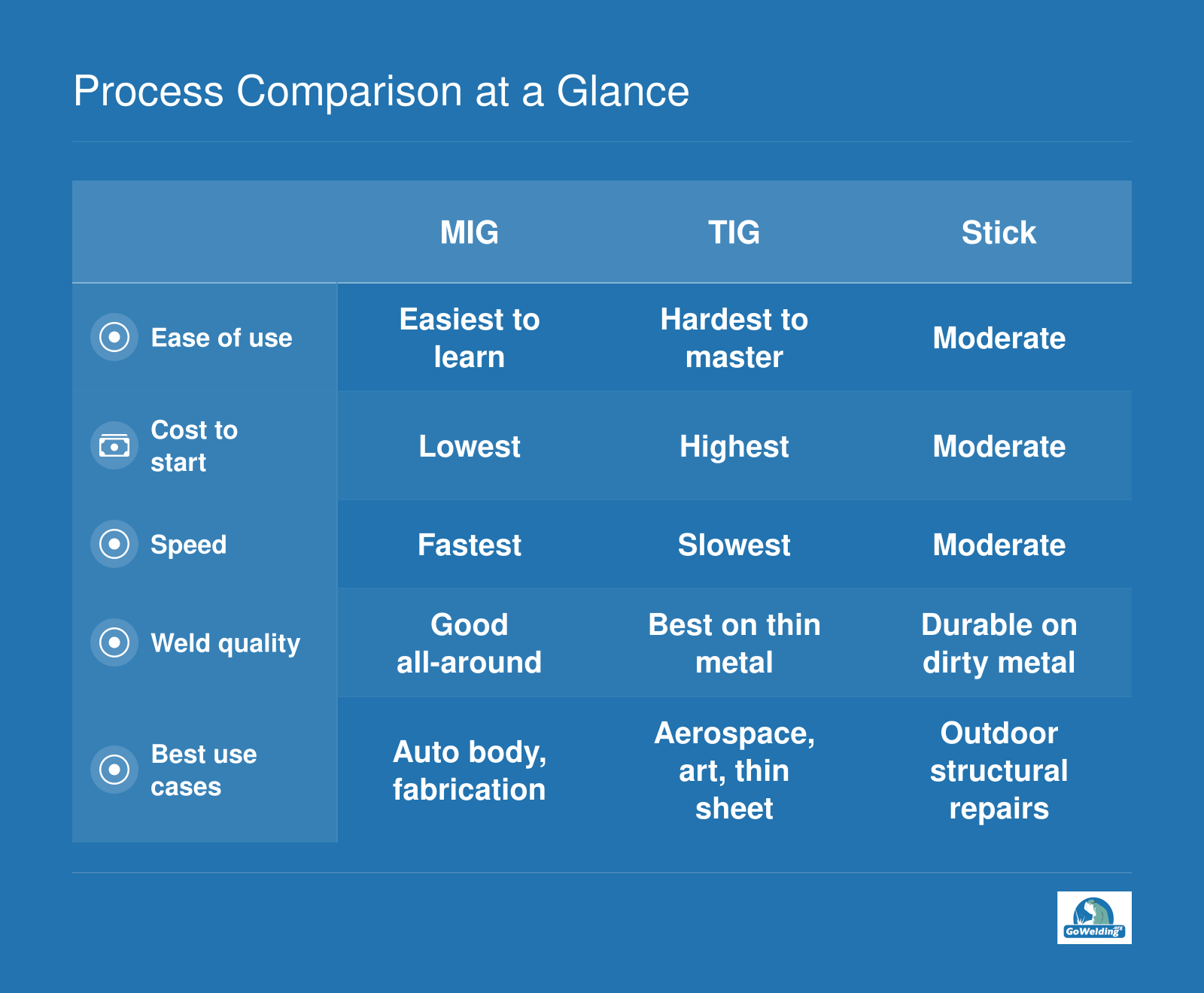

Process Comparison at a Glance
Use this quick-reference card to see how the three main arc welding processes compare before you dive into the full table below. The focus is on practical tradeoffs: what you will spend, how fast you can work, and which jobs each process handles best.
