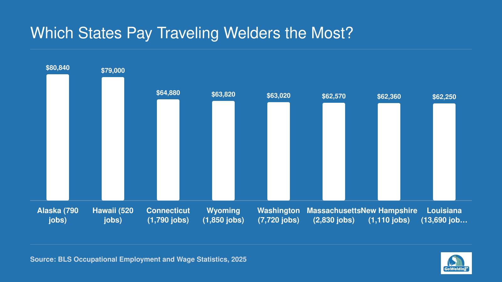

Which States Pay Traveling Welders the Most?
BLS state data shows that welders in energy and industrial hubs often clear $60,000 a year, with Alaska and Hawaii leading the list. These figures cover all welders, cutters, solderers, and brazers, but road work can push total pay higher through overtime and per diem.
Top eight states by median annual wage for welders, led by Alaska at $80,840, per 2025 BLS data.
Highest-Paying State for Welders
